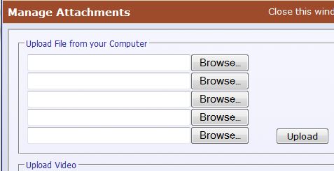

Click that button and it will open a popup window:

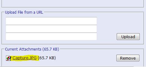

Click browse on any of those input buttons in the "Upload File from your Computer" section and you should be able to search your machine for the image. Once you do that, click the upload button. You should see it in the list of current attachments in that same popup window:
Close that little popup window and complete your post and submit it. The photo will show along the bottom of the post.

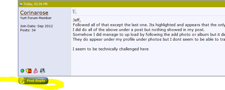

Don't upload them to the photos section.. Upload them directly to the post.
Click the Post Reply button first:

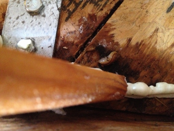

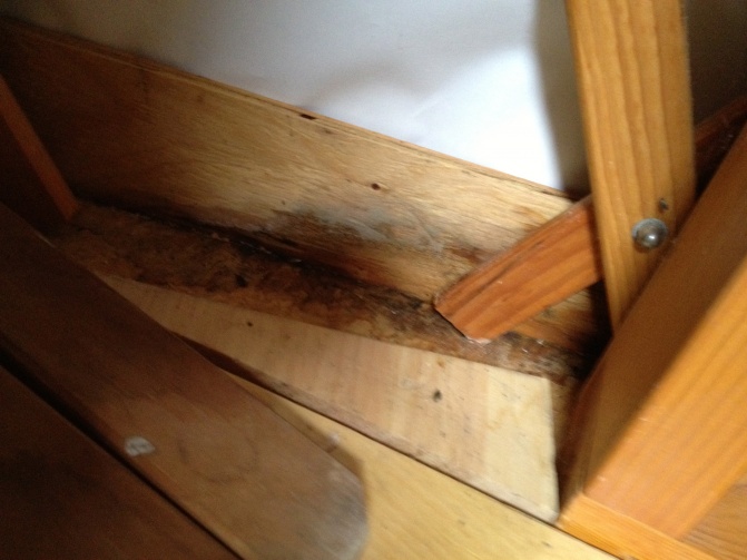

1st pic---where benderboard meets floor--liner is now pulled to the outside of benderboard
2nd--how wet the floor is--check out snail! the white foam is sealant I had used to stop the draft coming in where the liner met the floor

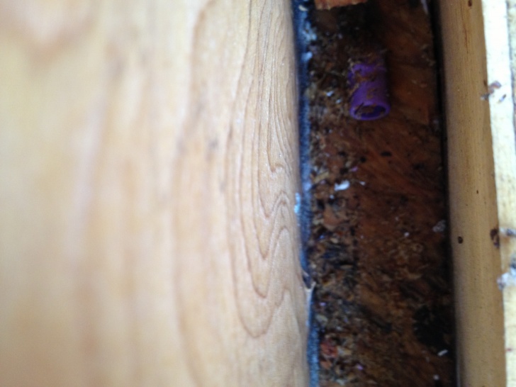

3rd is the gap between where the window frame is and the benderboard-- the black is mold.
