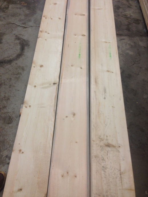

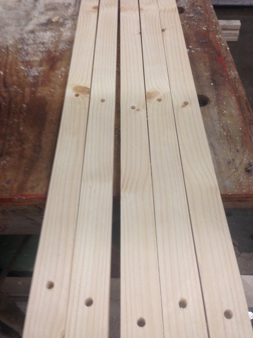

I set up the shed today to get into production mode. I ripped/drilled some khana as a test and am pleased with the results. However, none of my boards are completely clear. I took a couple photos of the boards and my results. The khana seem to be unaffected by the knots. Can you give me your thoughts?
Thanks!!
Ryan

To check before they go in the wall, gently flex and bend each lattice rip after the holes are drilled. If they don't break, use em. It's all a learning experience. Go for it. You're doing good. Keep it up.

Thanks! I plan on drilling then ripping. I can't imagine the extra work there would be if I ripped then drilled!
