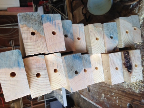

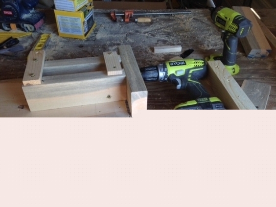

My platform is framed. My khana are finished (still need to assemble them). My rafters are nearly finished. I would like to get my floor down on Sunday. Im getting there. I attached a few photos.
Ohh, another question. Will I be able to use a circular saw to cut the platform to size? I have read of people doing such with plywood, but Im using 2x lumber.

The guys who did my platform used a circular saw. Looks like your project is coming right along!
Thanks!
Not saying it won't work......but your arc is a lot tighter than Jafo's and you are cutting thru 2x8 before they fall away.
Nice drilling jig.

Good job on the platform frame. Cut those 2x deck boards. If you bog down with a full depth cut, simply reset the blade depth for a scoring pass about a half inch. Then make another pass over the first one to about and inch, and then cut all the way through. I cut WAY tighter then 12' d. many times, no problem. Yeah the cut edge is a bit ragged but big deal.
