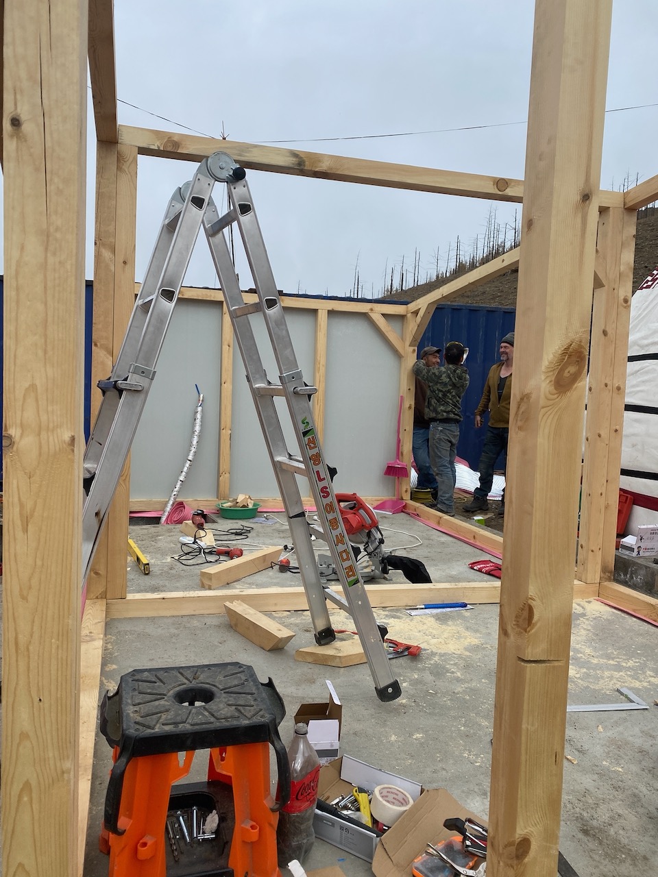

Following the style of the gers (10cm square post and beams with wide spacing), I'm continuing that style in the bathroom. The frame is mostly up with some additional 45 degree bracing to be added in the corners. Photos show temporary bracing with 5cm x 15cm rough cut lumber. Final braces (knee?) will be 10cm x 10cm smooth planed 4-sides. Also the exterior and interior doors still need to be framed. The 15cm thick wall and roof steel sandwich panels are coming on Thursday and I'm hoping to have helpers to install them. Otherwise it'll just be me and the wife which isn't appealing. My mother in law is the lady in the photos. She's been amazing, coming up to the camp every weekend and building rocks retaining walls and helping with any and all construction. She has no experience with any of it but she follows directions and never grumbles. That being said, she grew up in the countryside so she's no stranger to hard work. Now she has an office job, retiring next year, so perhaps she relishes the physical work for a change.

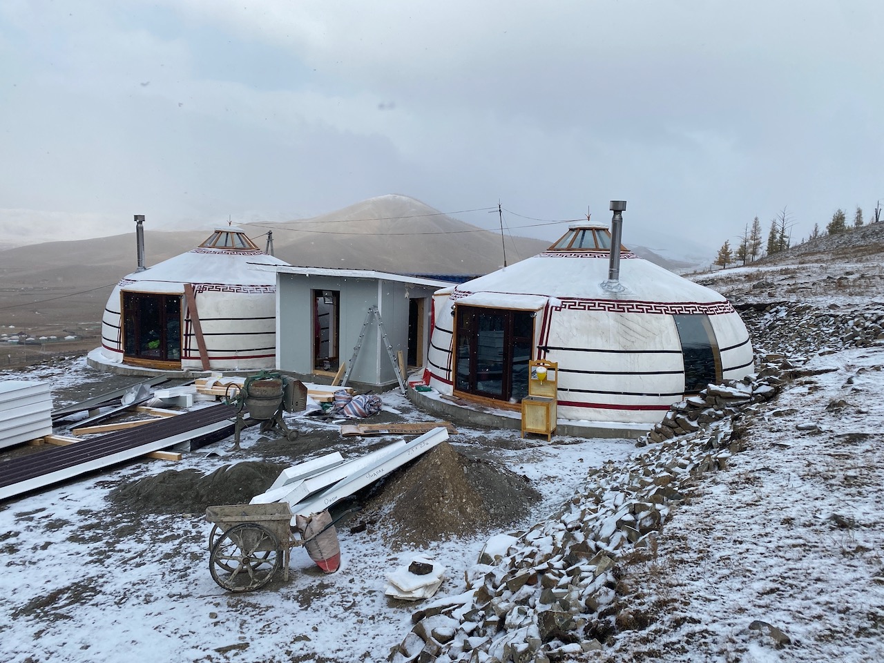

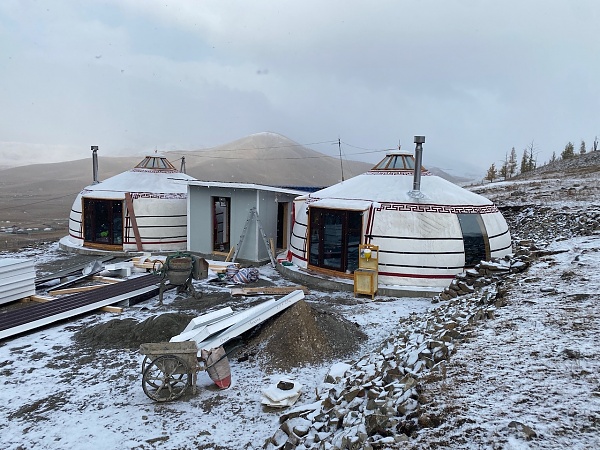

There was a bit of snow, maybe 10cm (4") in the morning. We continued working on Sunday, since it wasn't that cold .... yet.

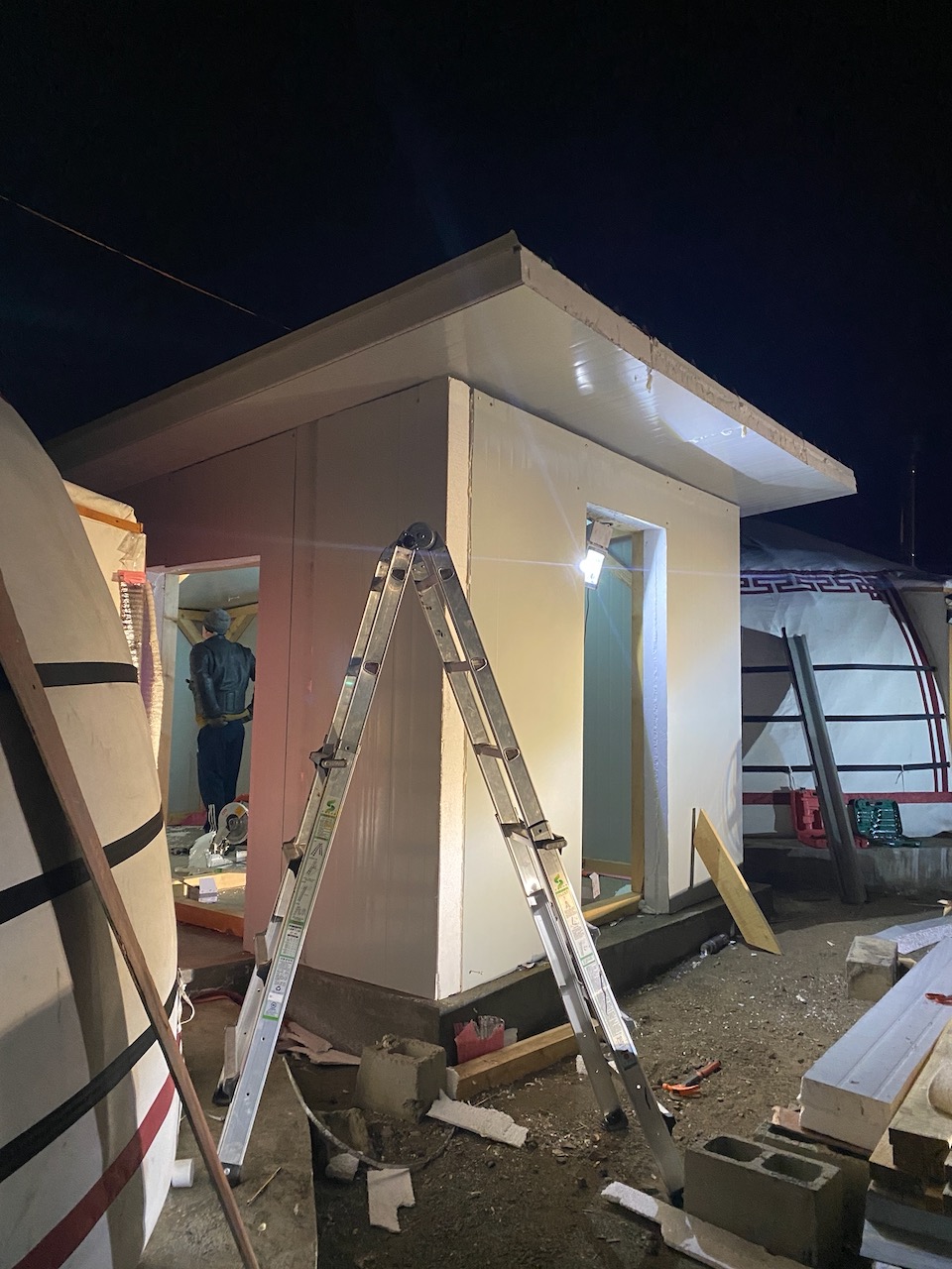

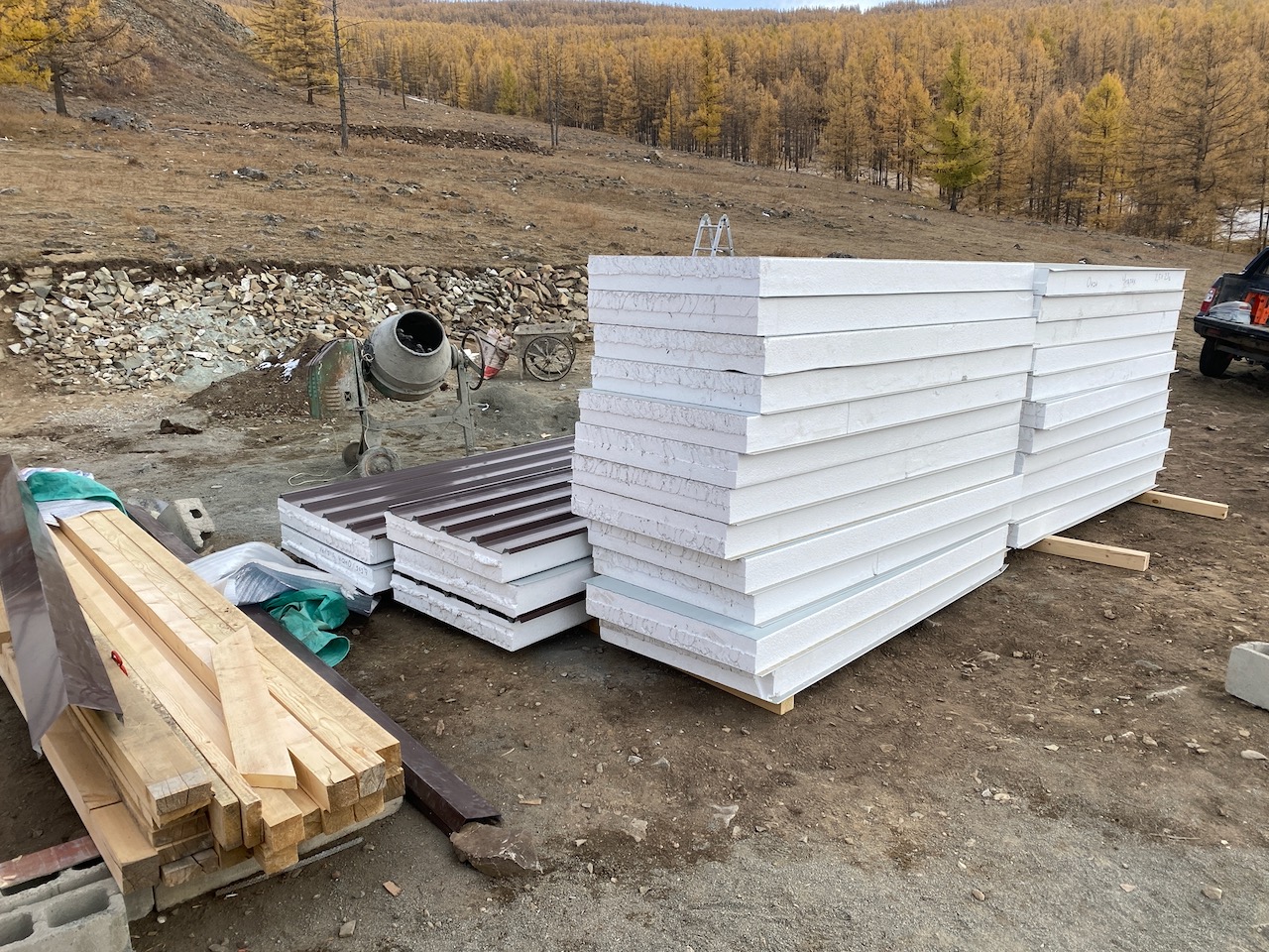

We made good progress during a very long work day yesterday (Friday). 13 hours to be exact.
I invited my long-time handyman, Paul (an Americanized Mongolian) to help out. He brought his adopted brother, Billy, who is usually a horse specialist but is very handy too.
All the sandwich panels arrived without plastic wrapping, so they were already quite scratched and dented from loading, transport and unloading. That's quite disappointing but this is Mongolia and normal quality control is severely lacking. I should almost certainly repaint the panels and I hate painting. Also the outside colour isn't particularly pleasing on the wall panels (light grey), whereas the roof is a decent chocolate brown, but is scratched up too.
Name:	panels delivered.jpeg
First, wall panels go up. The wall panels were all 2.5m long so every panel needed some sort of cutting to length and/or angle because the roof has a 5 degree lean angle.
Name:	first panels go up.jpeg

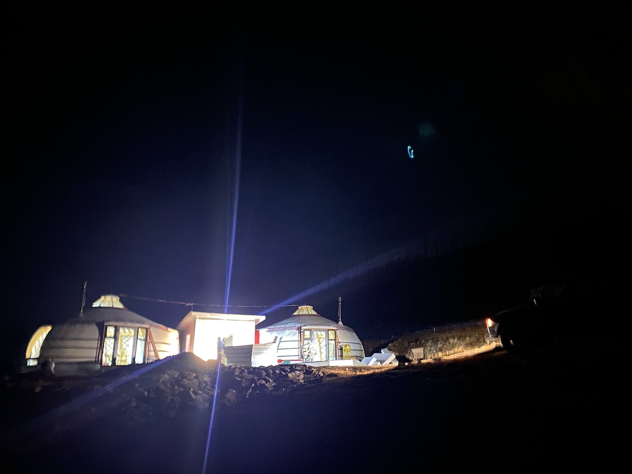

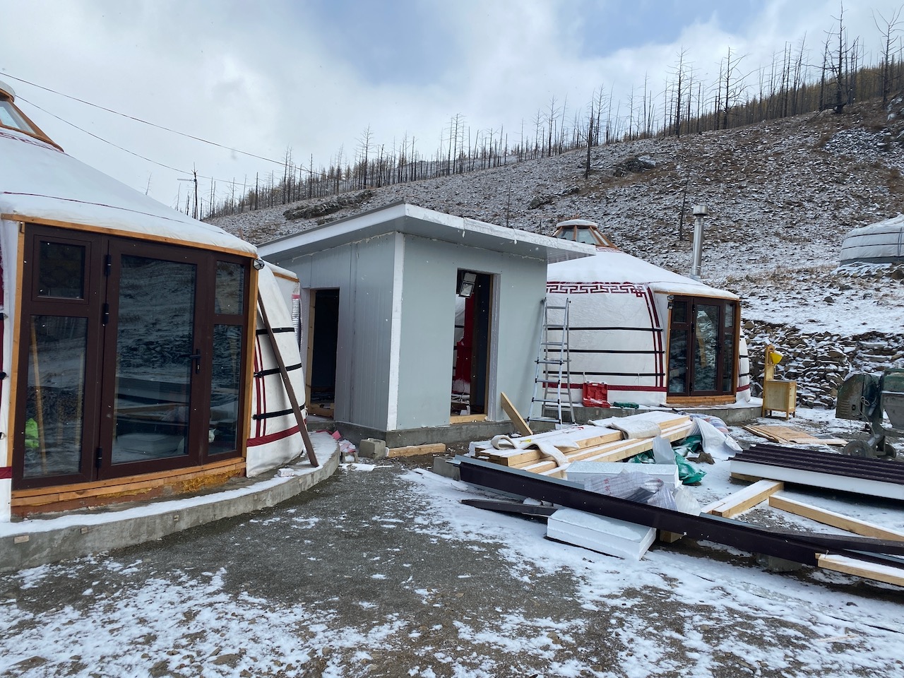

We worked into the night with work lights, head lights, torches/flashlights, etc. At the end of our 13 hour work day but we got up every single panel and PU foamed all the crevices. The gross exterior structure is complete.
We haven't done the connections to the gers yet which is complex. There's still loads to do. Trimming the excess PU foam, adding edge trim on the roof edge and the wall exterior corners. I'm just looking forward to when we can walk through from one ger to another without dressing for outdoor weather. Oh yeah, having running hot and cold water will be AMAZING.

The next morning it looks like a bombsite or maybe just a typical construction site. We had a light snowfall too.
