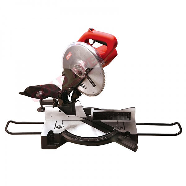

I just want to add that I have 2 new favourite tools.
A power miter saw makes quick and accurate cross cuts. It can cut through 10cm (4”) lumbar in one cut. Angle cuts are easy and accurate. Before I had to cut twice with a circular saw and ended up with sloppy results.

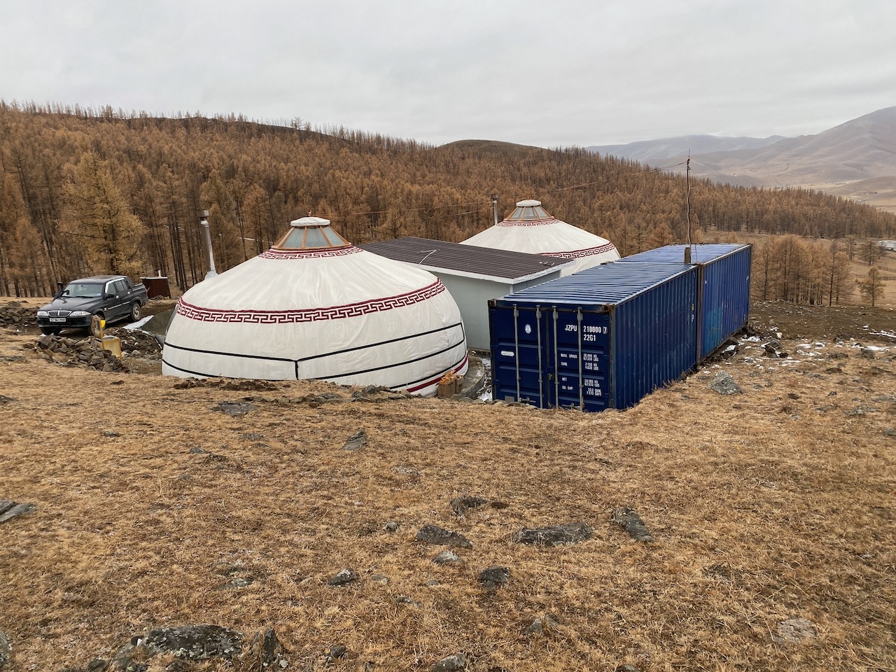

Thanks for sharing, Bob. It must really hurt to have the tools of your trade ripped off. I try to keep my most valuable stuff in our shipping containers. Gers have really weak security so I was adamant about buying two 20 ton containers with upgraded internal locks.

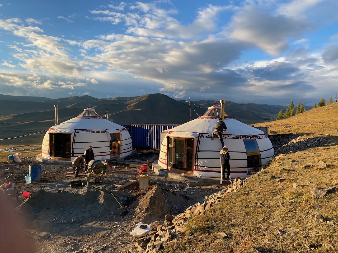

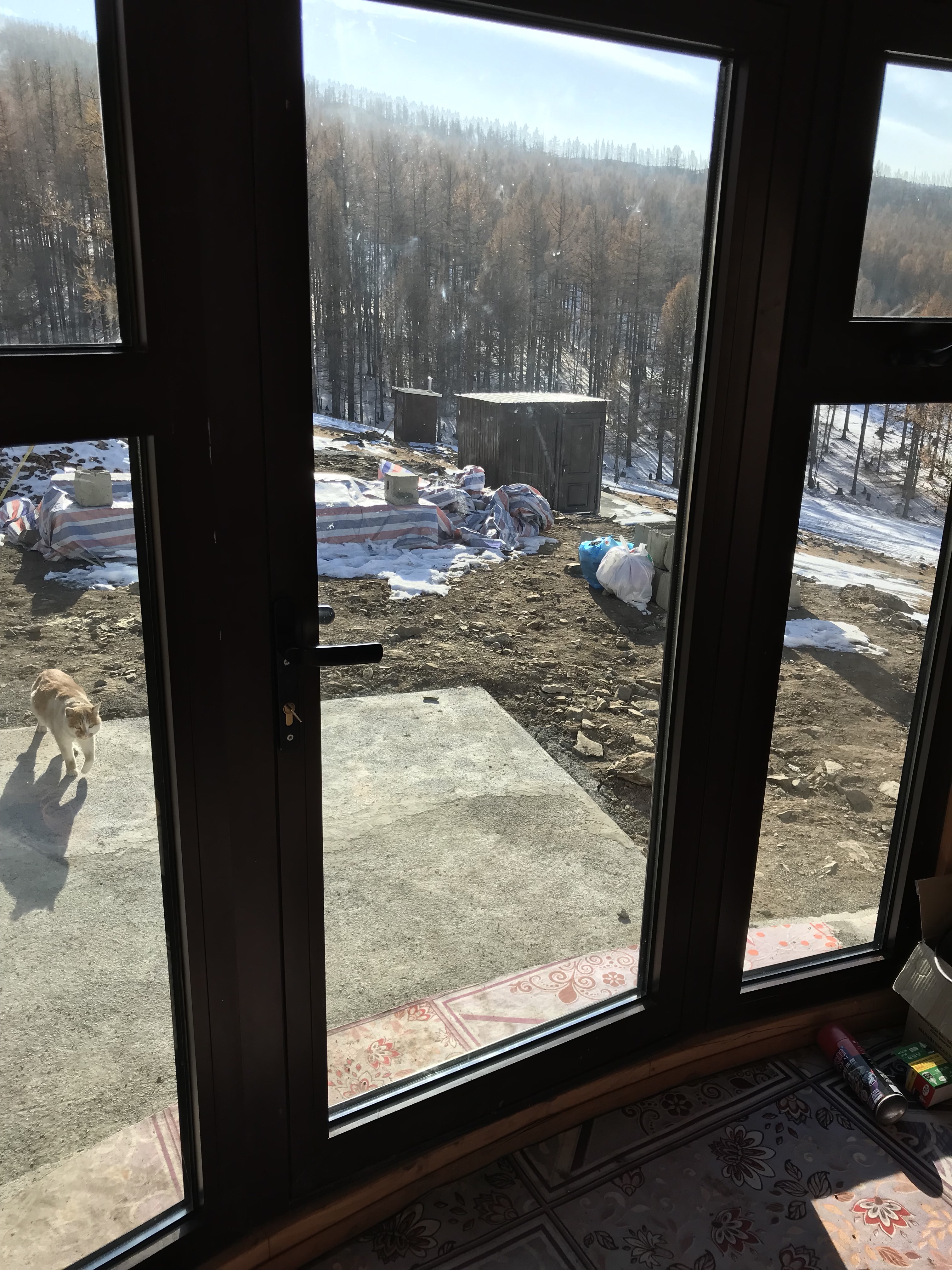

Let the photos begin with a recap. By September our gers were fully built but unconnected. We had an outhouse toilet and a well but nothing connected to the gers themselves. We had to hand carry water 30 metres in plastic containers from the well house.
And the winter came early. The well head/pump is in the foreground.

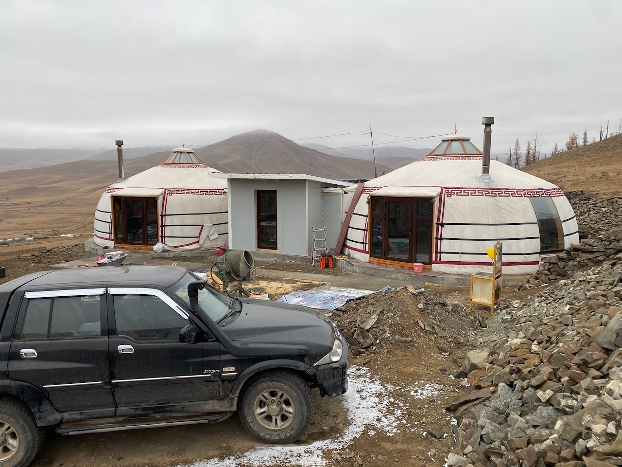

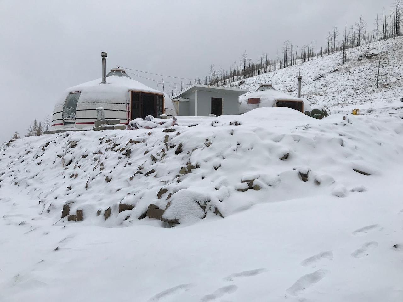

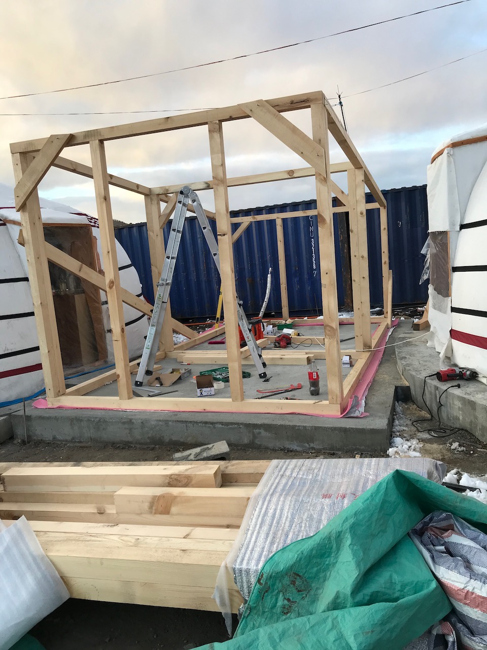

I got to work on the framing of the bathroom / hallway after some locals poured a concrete slab for me. Wall and roof coverings are the super fast install steel insulated sandwich panels with 15cm (6") of EPS.
Name:	progress on framing with temporary braces.jpeg
It was an upgrade to be able to walk through from living room ger to bedroom ger without going outside in this kind of weather.

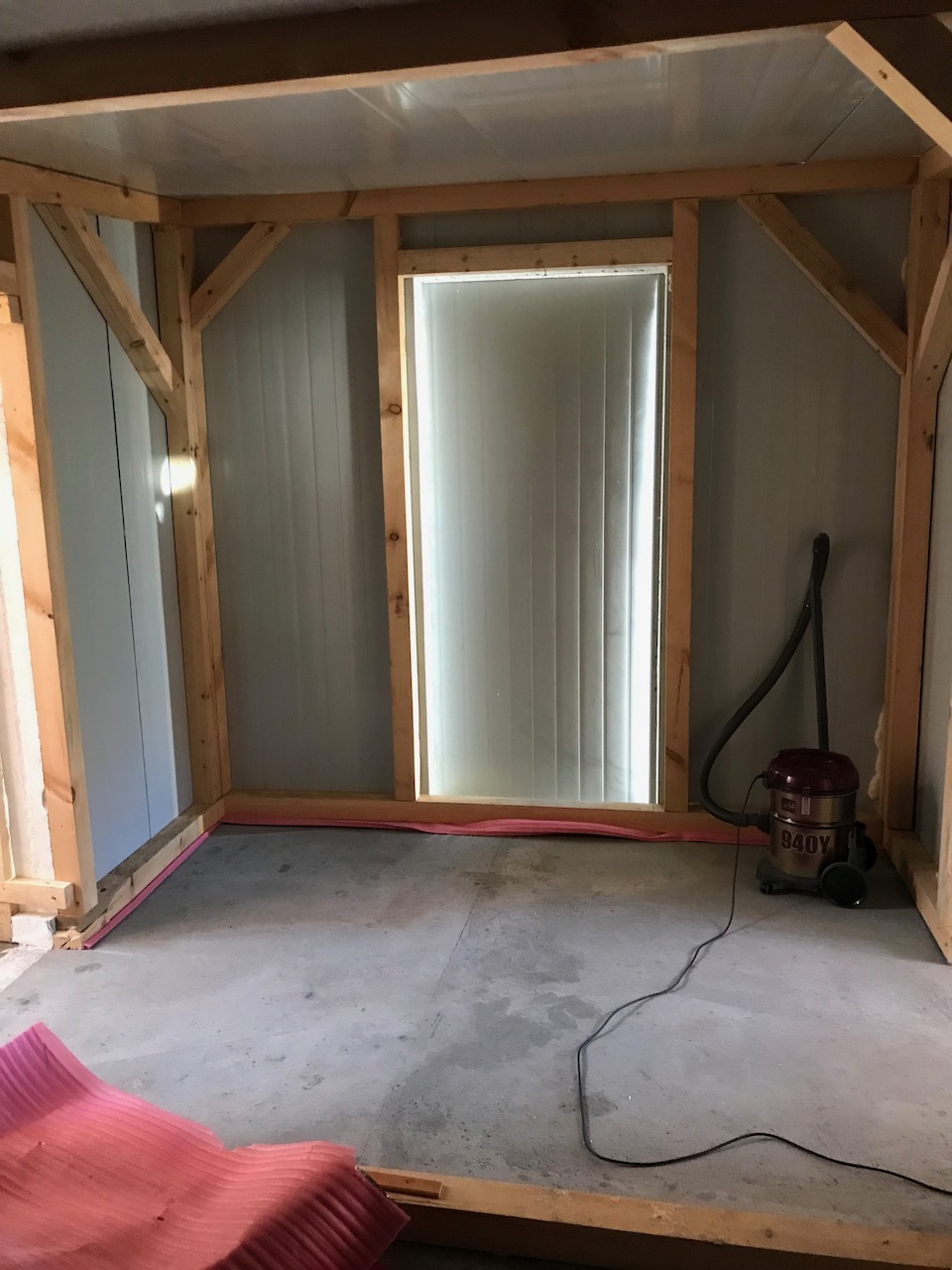

Here are some progressions of the interior of what was essentially a shed/barn style build.
Roughly framed and covered. Temp door.

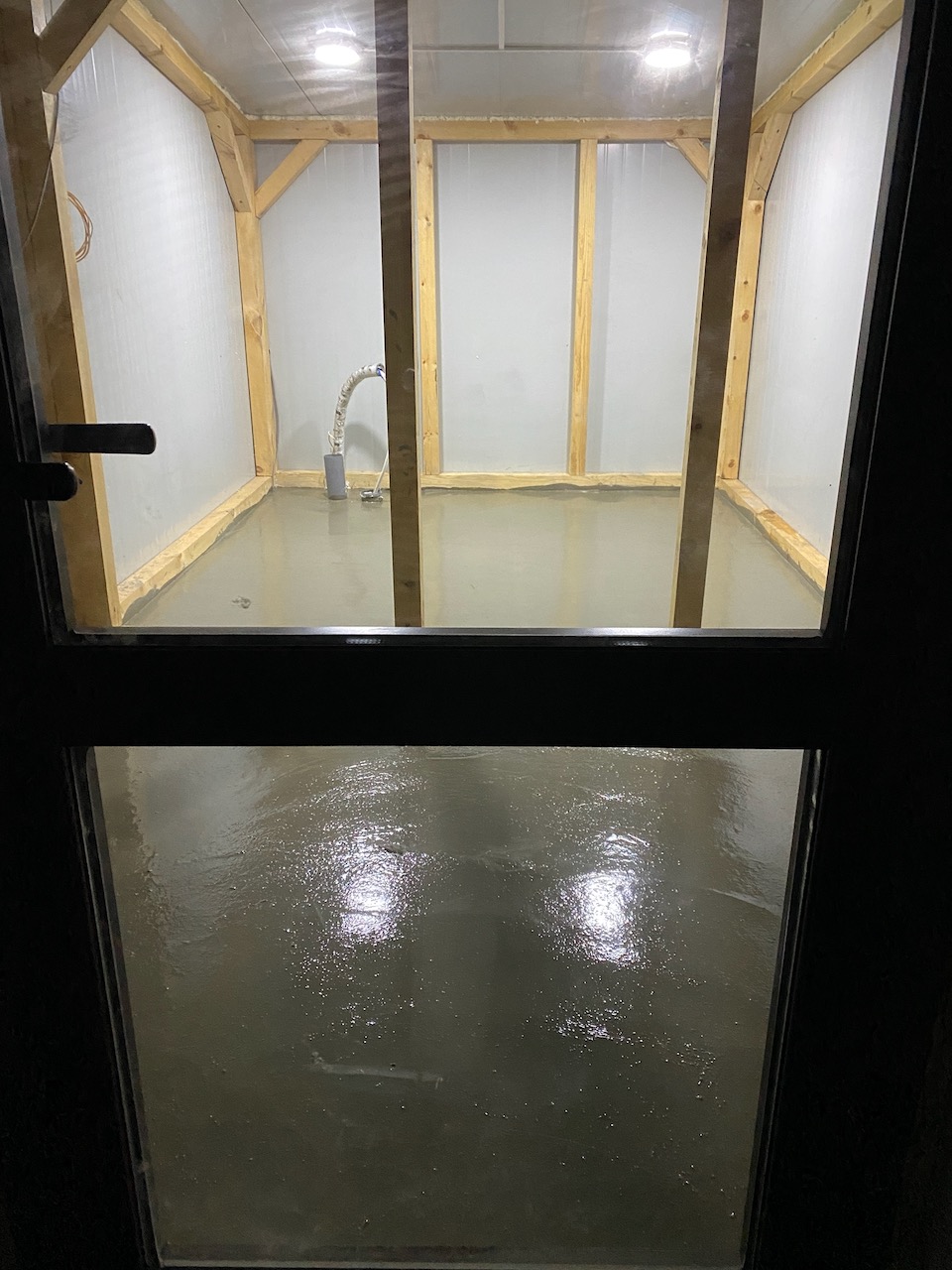

Pour self-leveling floor. Install double glazed aluminium door. Lots of passive solar heat in the day.

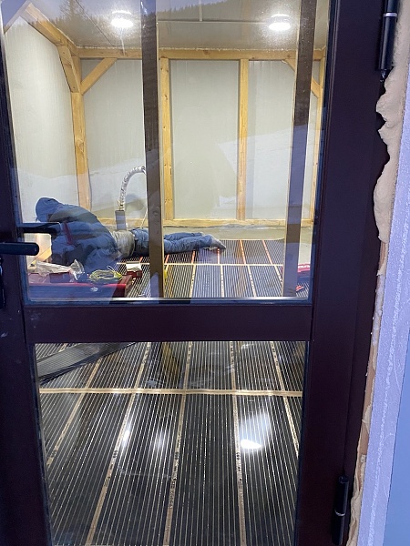

Lay
insulation
pad and underfloor electric
heating

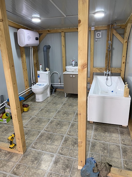

Pour another layer of self-leveling floor (not shown), let dry for a few days and then glue down vinyl tiles. Do all plumbing and electrical connections.
We are still missing walls and barn doors (glu-lam panels), window above sink and lots of trim to hide the rough bits. I might leave the plumbing exposed because I like it and it's easy to access in case of problems.
We still have lots of finishing touches to do which may go on forever. BUT we can take a bath, a shower, and use the toilet. After 6 months of NO indoor running water/bathing etc, it's the simple things that I took for granted which now seem like luxuries.
The heating is keeping up nicely with night time temperatures down to -22C (-8F) and dropping to -40 C/F on the coldest days of January. The well house and one container are insulated and have WIFI enabled radiators which I can monitor and manage from the gers. So far they are keeping up. Batteries and a diesel generator provide backup during power outages. Wood stoves and a propane space heater provide supplementary/backup heating.
