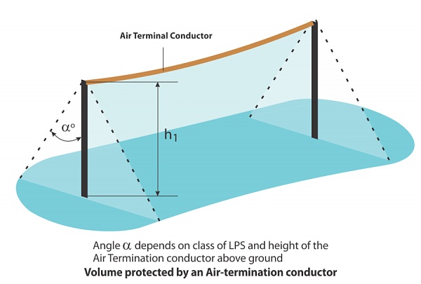

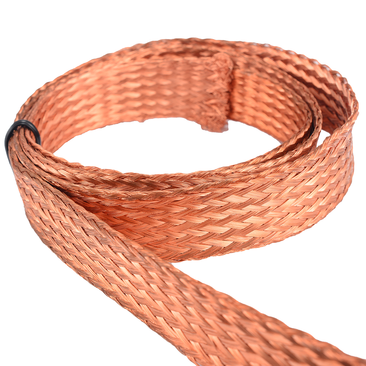

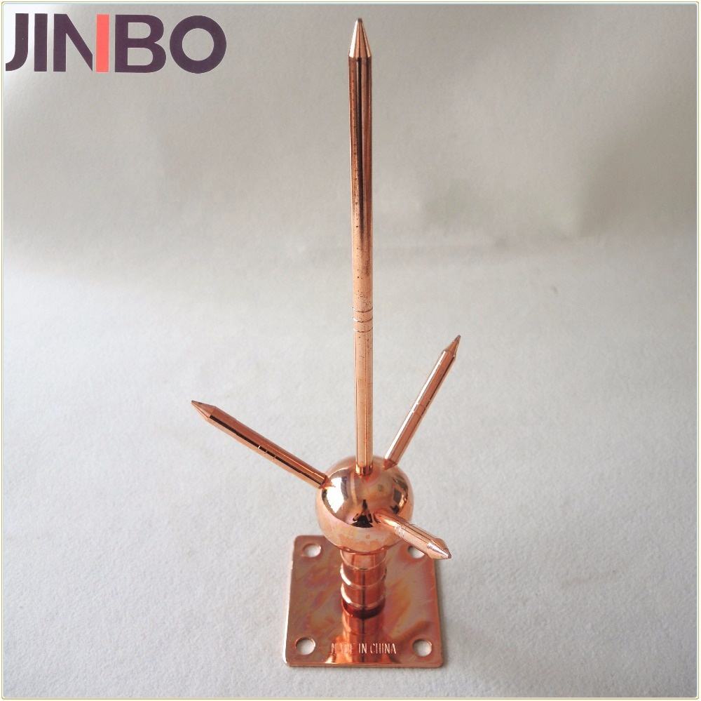

Thanks for the reply. I’ll post the photos of the actual finished project later this week.
I added a link to the diagram of the theory. It only shows 2 connections but I may have 3 roof rods and 3 air terminals (copper wire between) so it’s not exactly the same.
We don’t have our wood stoves connected yet. I’ll probably need to ground the chimneys too after they’re installed if they are tall enough. Not sure yet.
TSRalex likes this.
Old 07-25-2022, 12:03 PM   #10
Join Date: Jul 2018
Location: Austria
Posts: 168
Lightbulb Re: Lightning rod for a yurt in an open field?
Quote:
Originally Posted by UKadventurer View Post
Systems as shown in the diagram I´ve seen in army camps & the staff areas of refugees camps.
Maybe you can find from this side some more detailed information....
UKadventurer likes this.
