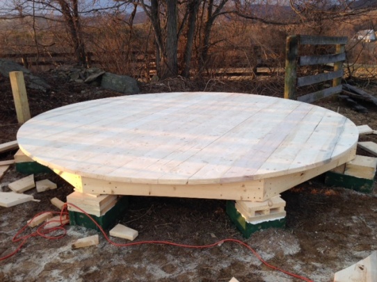

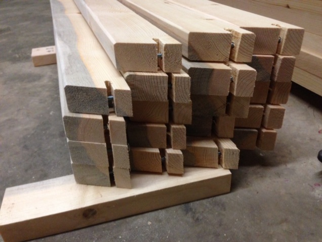

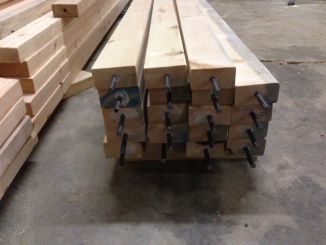

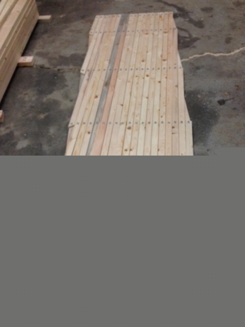

Thanks for the tips Bob! I found a cone shaped flashing that I may be able to attach to a larger sheet of flashing (my roof ring is 36in in diameter), which would work nicely without the need for excessive trimming with snips (which I abhor).
I assembled a khana wall today. What a relief that all the work I have performed up until now will actually work. I was so worried that I wasn't accurate enough in my drilling and cutting that the khana wouldn't line up correctly. But it all worked out. Tomorrow I plan on assembling the other wall, framing my door in the door frame, and framing my window. Hopefully will start putting it up on Thursday!
Ryan
