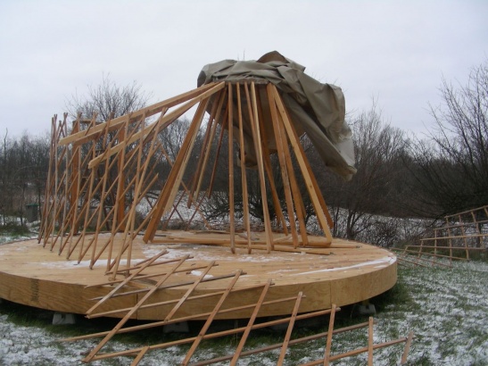

Thanks for the specs you note! There are a few things I know I'd do on a new one - bevel the
center ring
to butt directly against the rafter ends, and use some kind of bracket to mate the rafter end into (instead of the simpson that I doubt was designed to be used that way).

Wait, did I read that right?
The rafters were affixed to the roof ring with simpson brackets?

And screws, yes. Thoughts, bss?
I think, myself, that they alone were not the reason for failure. In fact, they held the rafters to the
center ring
throughout - even as I was trying to push the whole thing over. It looked like something out of War of the Worlds. Maybe a female alien, with a lovely head of vinyl hair. This deserves a photo...
BUT, I think it goes without saying that there are better ways to join rafters to rings.

Wow what a mess I set up one of my yurts one winter with no wall covering at all just for the heck of it and to see if I could come up with a way to make it stay put. I had the cover blow off once. had trusses raise off the wall, but never had any collapse what so ever. what I did was thread ropes down through the walls to an anchor in the ground in equal parts of the wall. And put a rope around the top through the trusses to keep them from pulling out of the roof ring. this also keeps the roof from inverting due to weight. My little test taught me a lot about ways of doing things. just my two cents worth.
