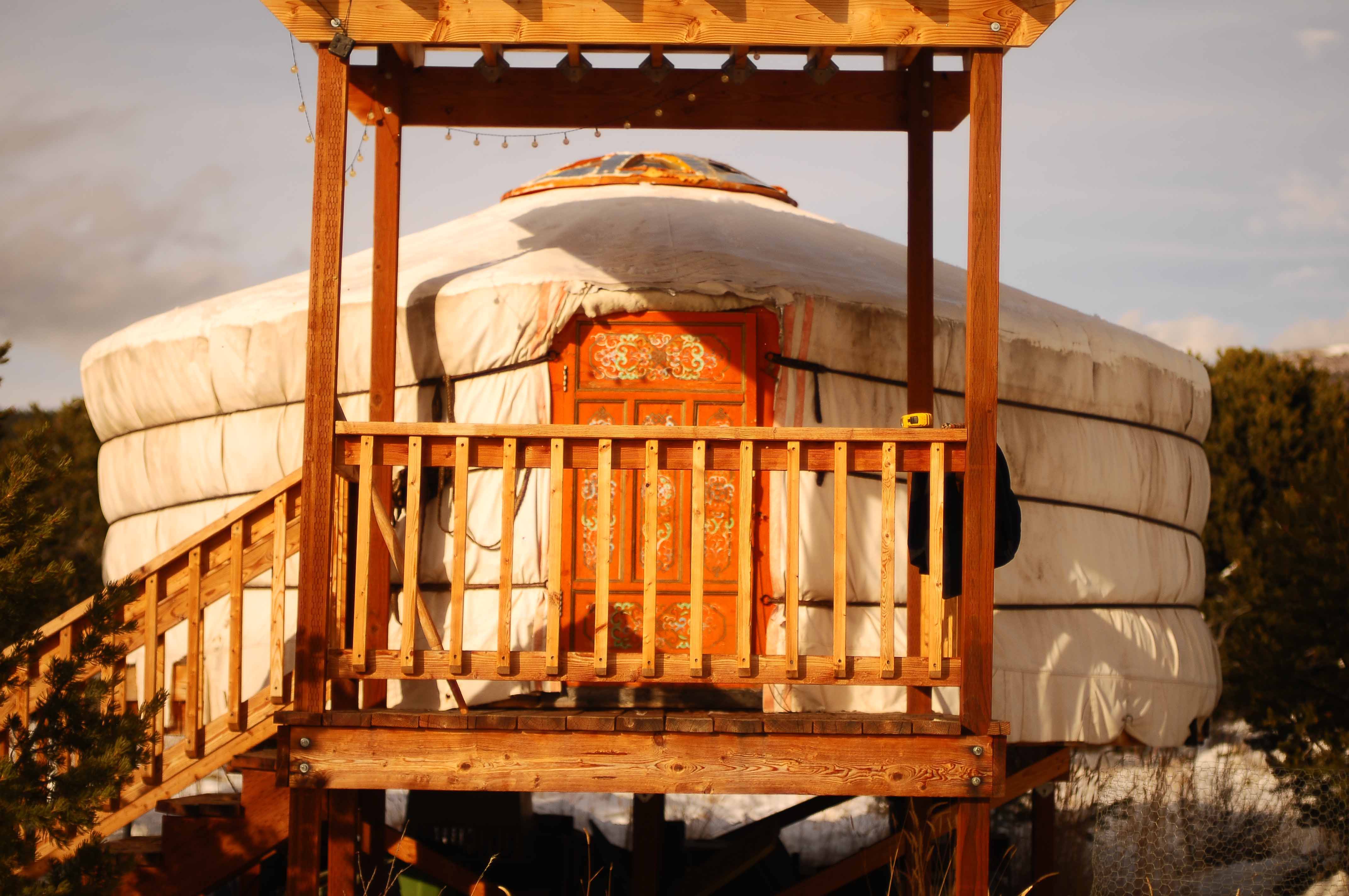

Hi There,

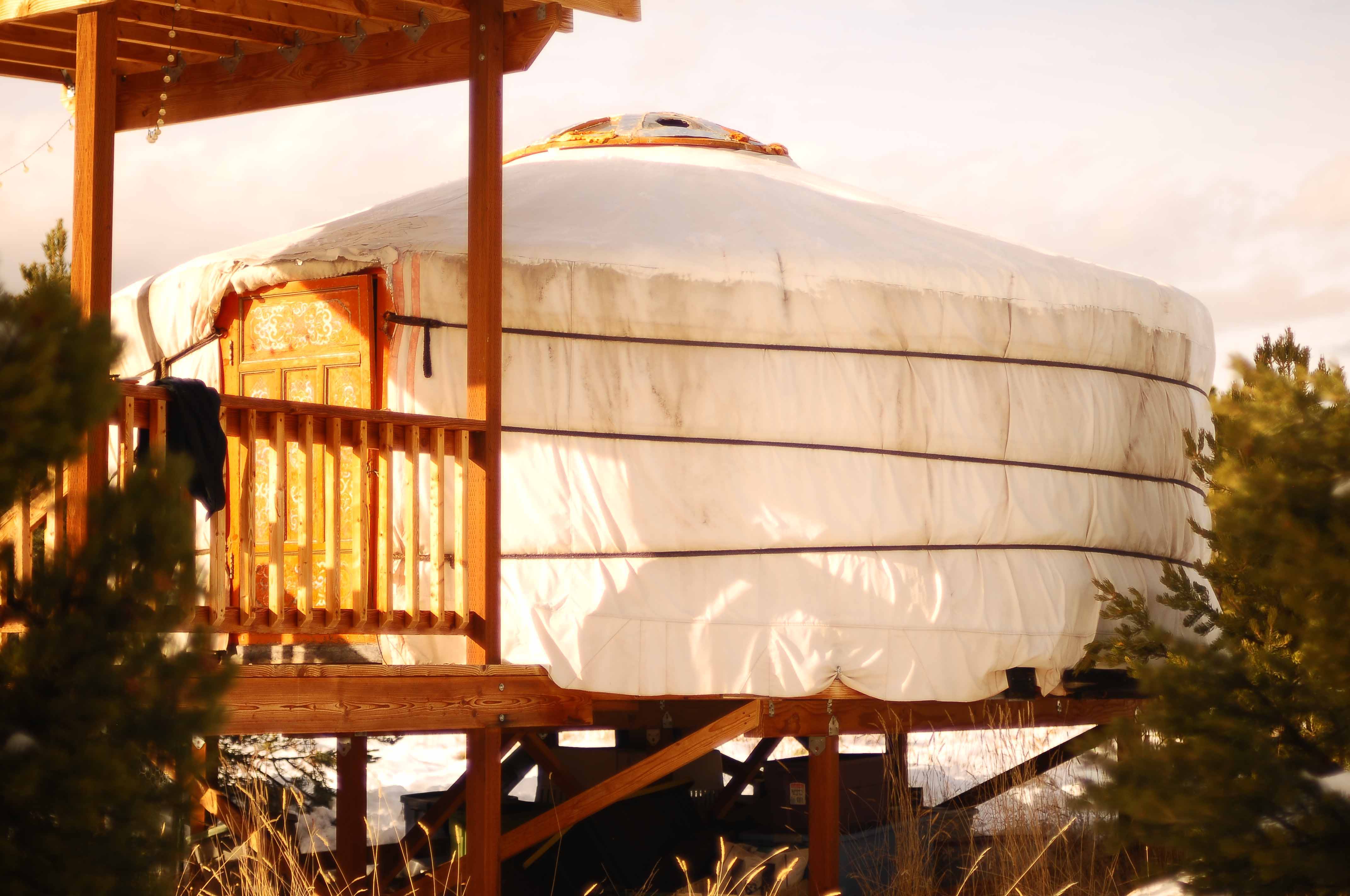

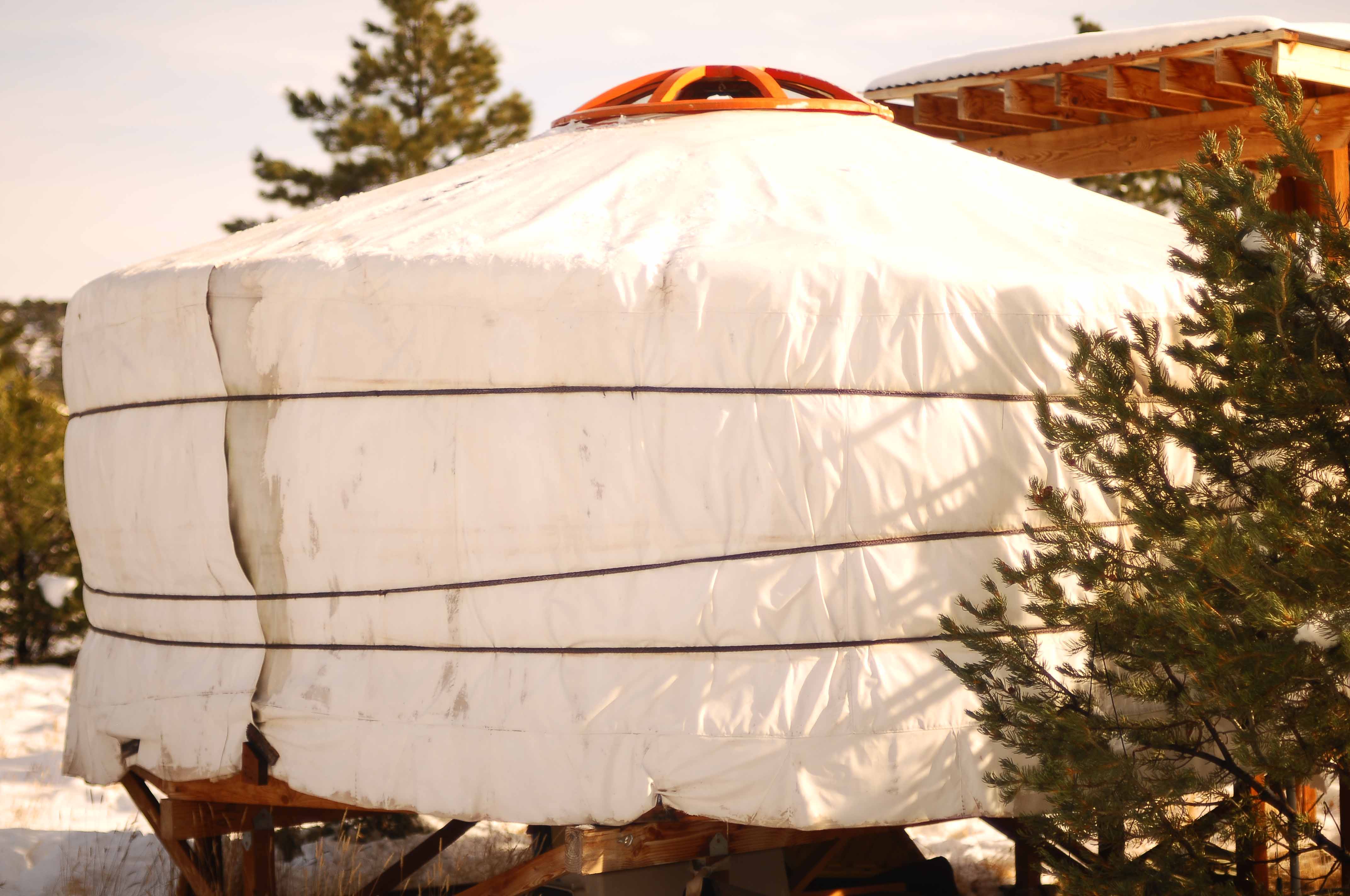

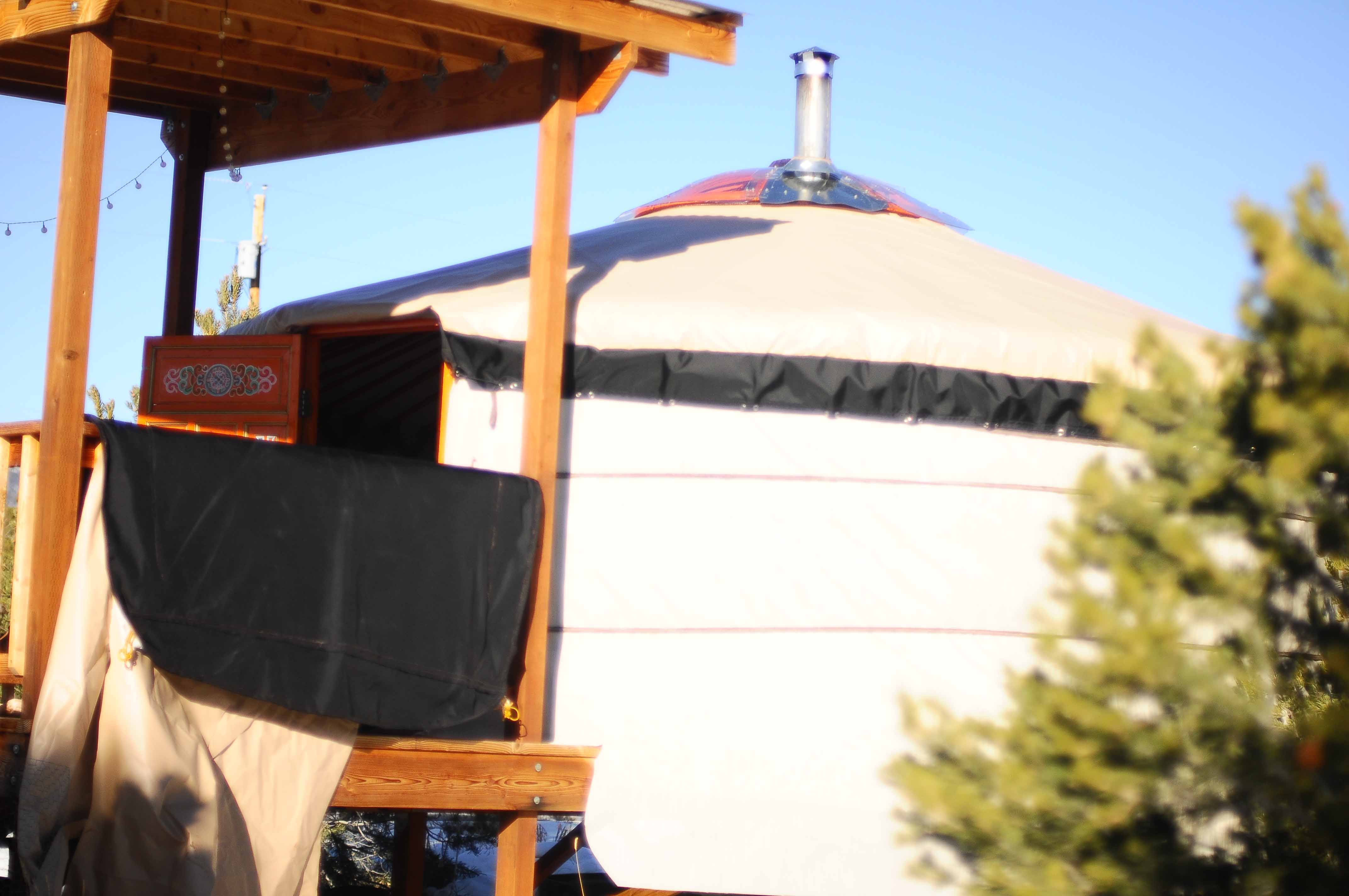

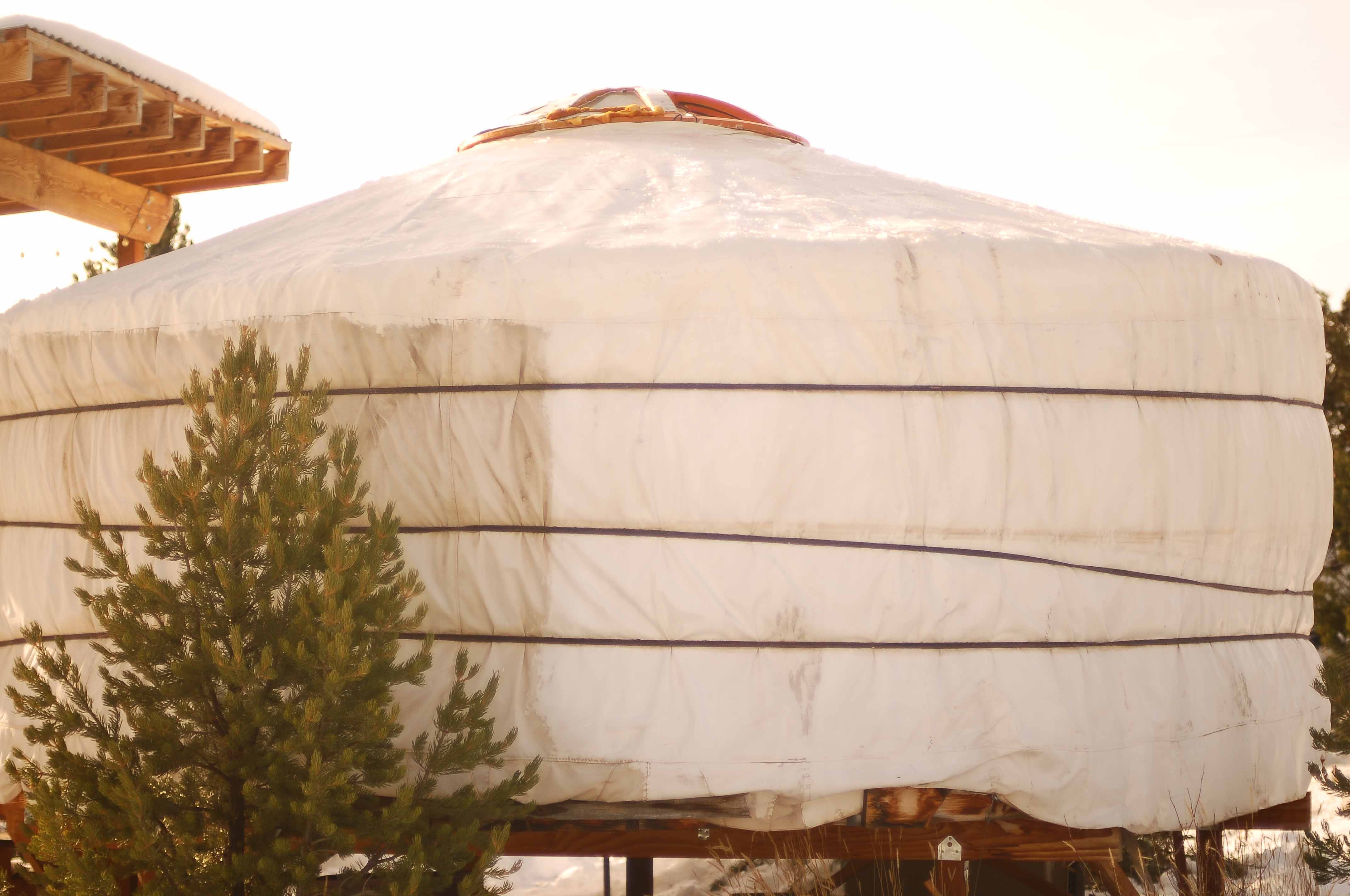

Just finished a new cover for a traditional Mongolian yurt in central Utah.
email me at : [email protected] for more information
Before Photos:

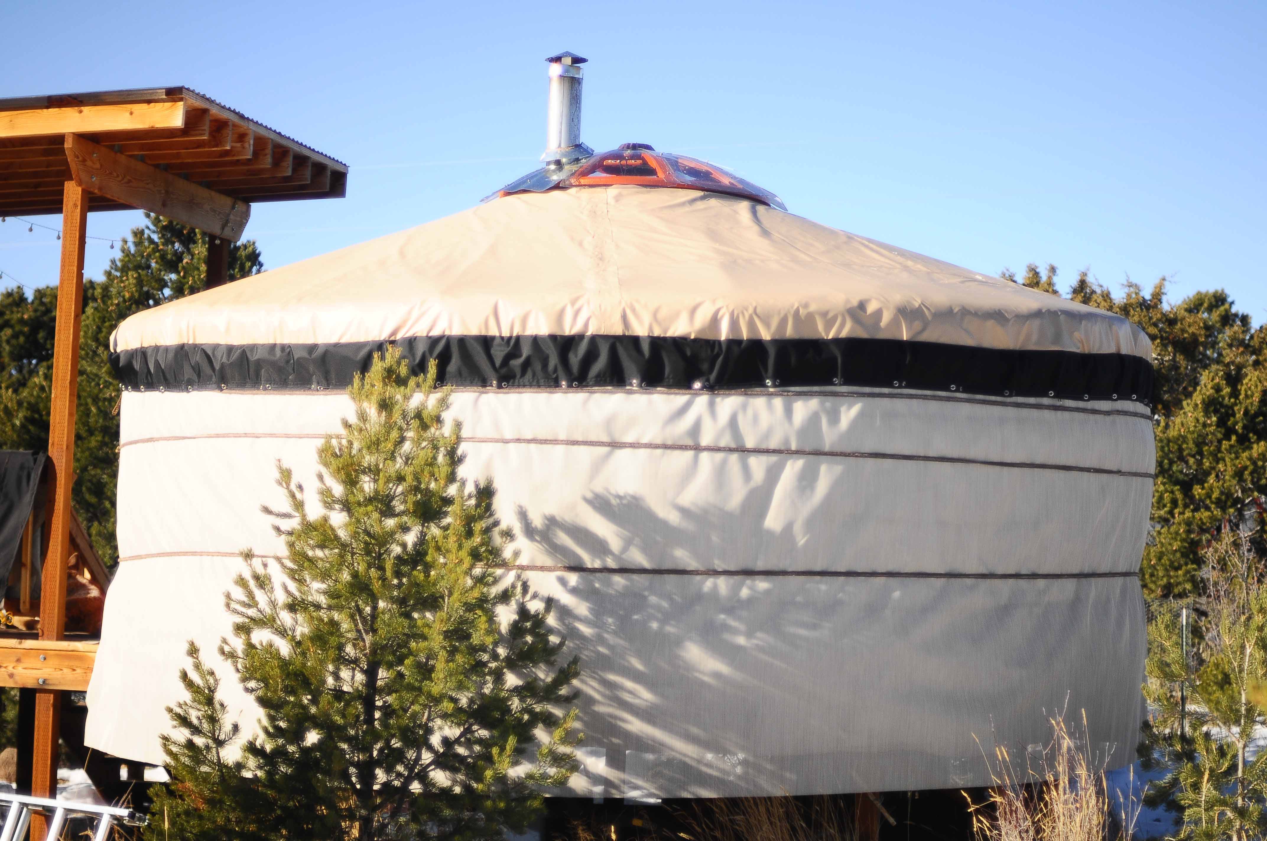

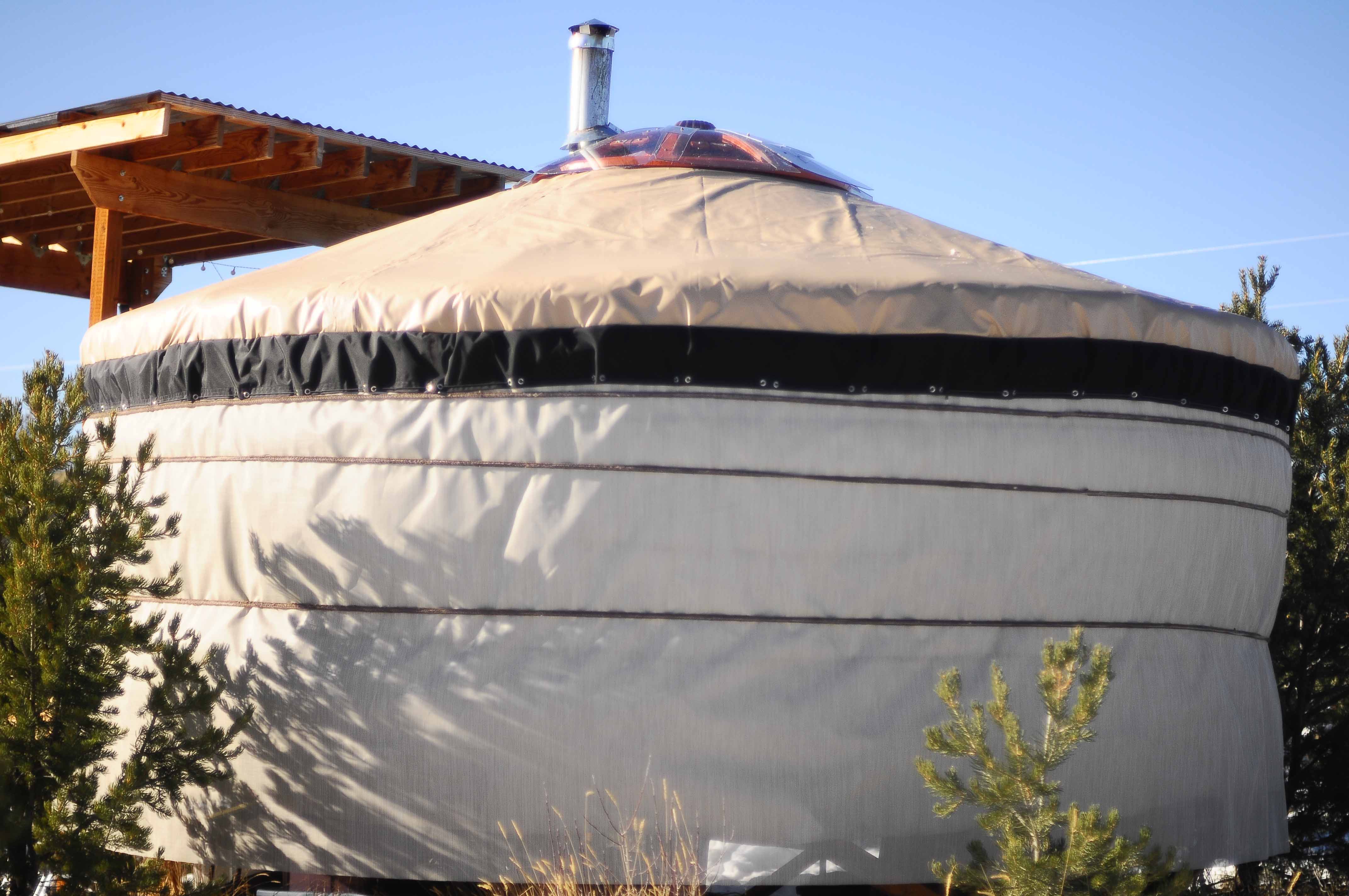

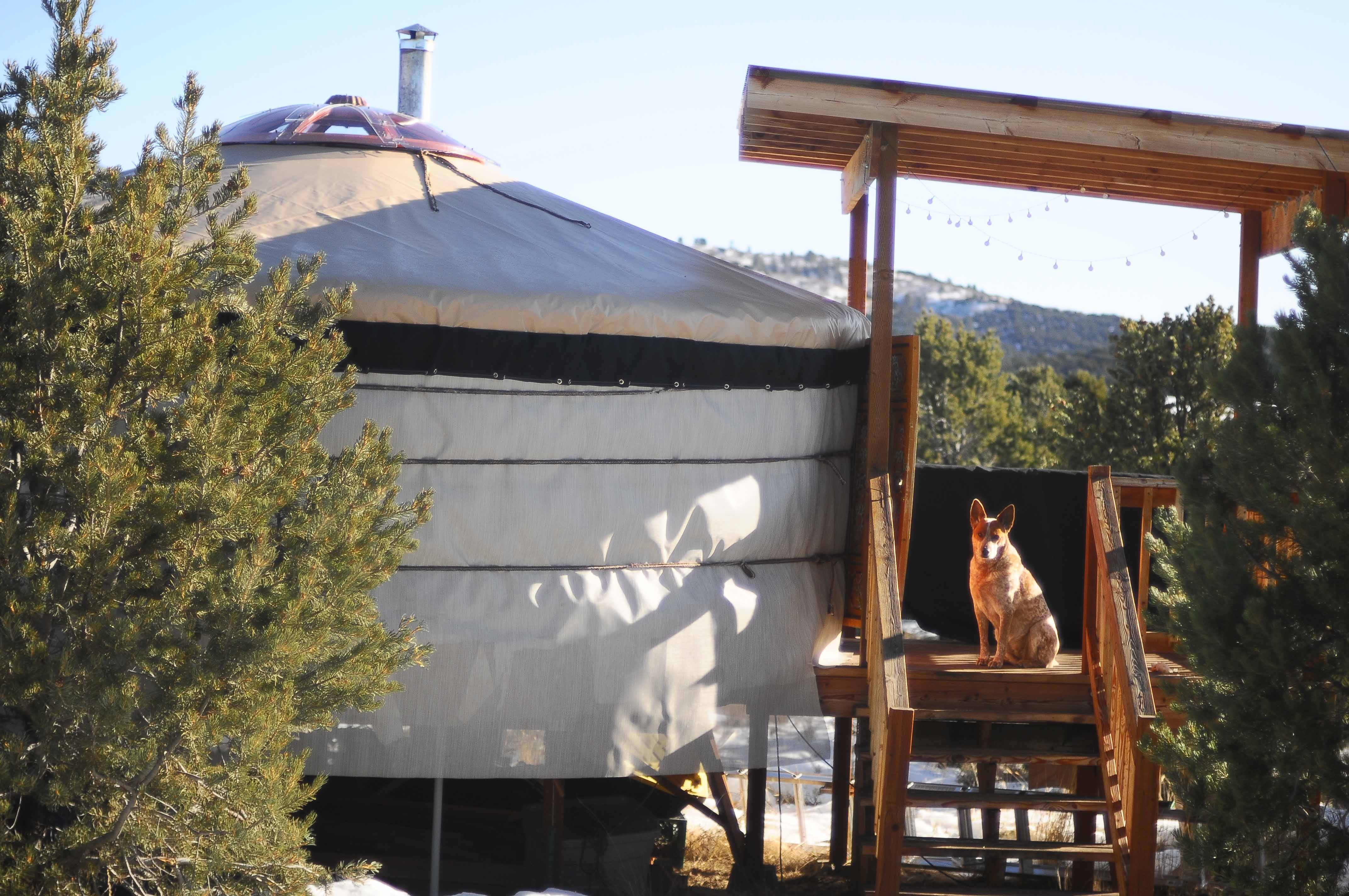

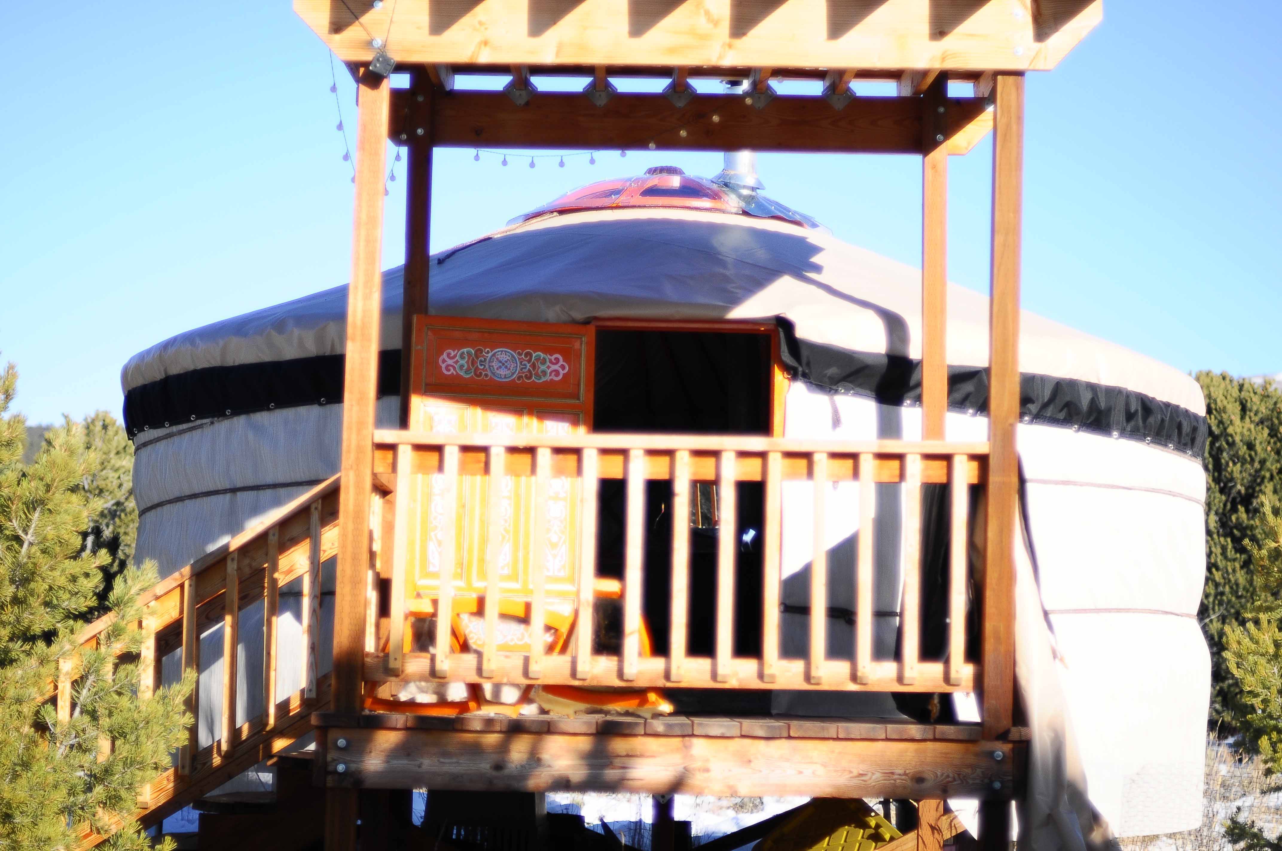

After Photos:

Default Re: Roof and Exterior Wall Replacement
Thanks Bob - BTW,
Sewn on a 1954 Singer 301 (souped up) with black exterior marine grade thread (used for sewing sail cloth).
The Roof is heat seamed -Flame retardant Tan 18 0z. Vinyl Coated (not laminated!) Polyester.
Valance strip is sewn on - Black 1680D Ballistic Nylon, with double nickel grommets every 12" - inner and outer cinch cords are 550 para cord.
Wall cover hangs on inner cinch cord with "s" hooks and grommets or jib hanks and rivets - Fabric is 'Desert Sand' UV treated shade mesh (to preserve breathability) over the existing yurt wall covers, I use Textilene 90. https://www.ebay.com/i/330440954081?...iABEgIVoPD_BwE
Still haven't found a rope better than horse hair! Beautiful stuff.
