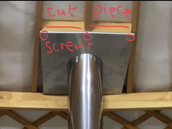

Is this rafter running through the chimney?

No, the rafter is cut and then the cut piece is used as a cross brace to support the cut end to the two neighbour rafters. You can see the cut piece (now a brace) at the top of the metal collar(?). It also gives something for the metal to be screwed to. There’s another piece of scrap wood at the bottom of the collar. Now hidden.

Thanks for the explanation.
It was my assumption, that you has reduced this one rafter nearly on an "Fake-Status".

No attempt at trickery. It’s a pretty standard construction technique. The installers wanted to cut 2 rafters but I insisted only 1 needed to be cut. In any case, I’m very happy with result. The only thing I don’t love is that the stove is about a metre from the wall. That wastes some floor space.
It could’ve been closer to the wall with a vent that goes horizontal but it needs a much more complicated chimney with 2 ninety degree elbows and visible supports outside. The vertical chimney is cleaner visually.

Carpenters call the cross piece a header. Also what they call falling off a wall. Been there done that a couple times
