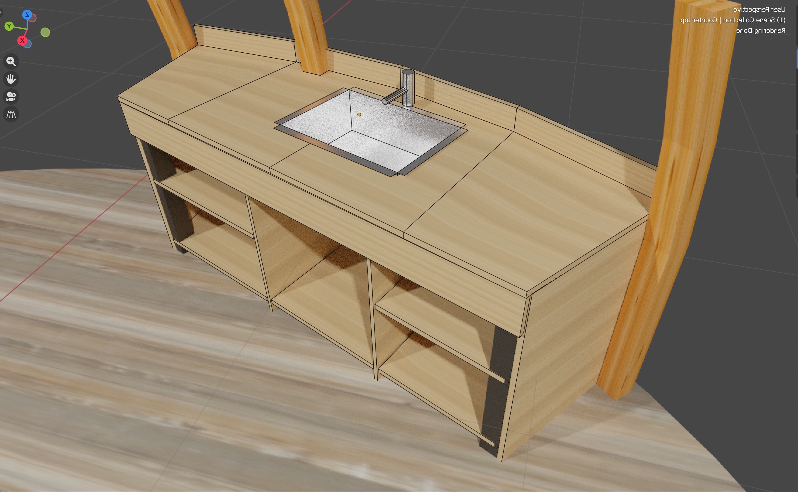

So here's my 5 meters (16 feet) of kitchen furniture / countertops which I designed and built with help from my handyman. I design in Blender3d (open source 3d software) then built with glu-lam (I think) sheets (25mm/1" thick for the countertops and 17mm/3/4" for the sides) and some 10cm x 10cm (4"x4") lumber for legs.
I've still to attach the wheels on the stovetop (propane) island and some internal shelves but, finally, the kitchen is fully functional. Probably do some more oil, lacquer, stain work. Currently I've just added several applications of mineral oil to make the countertops more resistant to stains and water penetration.
The sink countertop is more complex due to dealing with a curved (on 2-axes) wall. I kept the front linear and just follow the curve of the back wall, notching the countertop to fit around a support post of the ger/yurt. The final countertop changed a bit from the design. We decided to add 10cm square posts because they match the aesthetic of the ger/yurt. However, they weren't strictly necessary. The length is 2.44m (8 feet). My handyman did the plumbing which was probably the most complex thing because it hooks up to the bathroom and has to go round 2 corners and still maintain a fall for the drain.

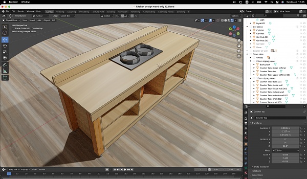

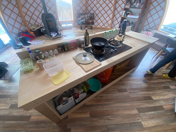

The stovetop counter is an island which can be moved around because the stove is a 2-burner propane type and the gas bottle can be contained under the counter. We could've gone electric but we have outages often enough to decide propane gas was more reliable. The design to build is pretty much identical, although I haven't put shelves in it yet. There is a cantilevered bar with seating for 4 people. [

I rounded the corners of the bar and backsplash and oiled it a bit more today. I really like the oiled look.

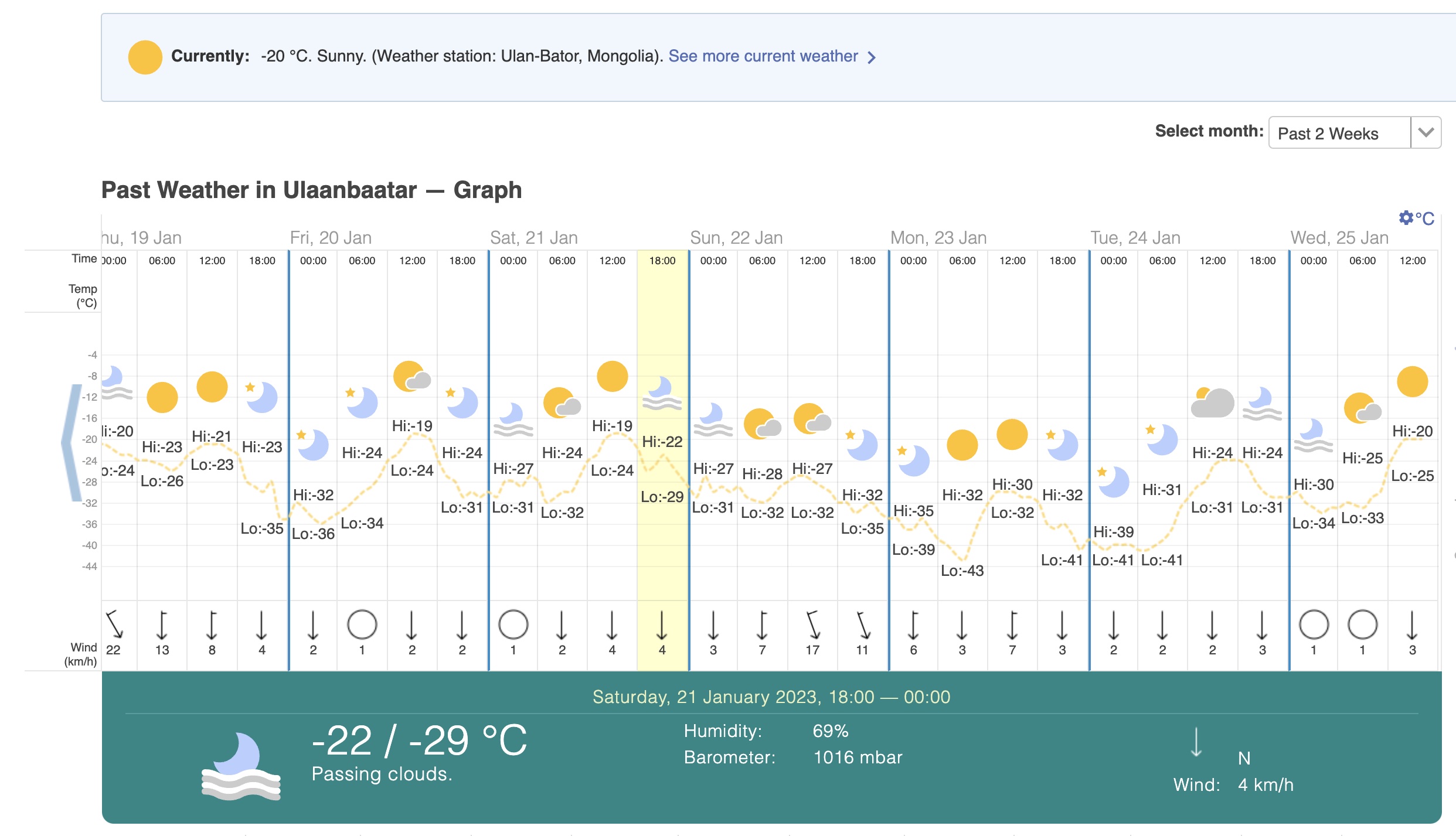

In my case, I think we're over the worst of it and I'm VERY relieved. This winter was colder than most. Every 10 years or so, we get a colder than usual one. This has been one. Before now, the lowest I've experienced is -46C (-50F) in January 2011 when I lived in an apartment in the city. The last couple of nights were in the -40's (same in C or F). Take a look:
Name:	Past weather late Jan UB.jpg
It reached -43C (-45F) ambient temperature on Monday night, -41C (-42F) on Tuesday and then just -34C (-30F) last night. Luckily the forecast is trending warmer in the -30C's to mid -20C's. Which seems positively tropical for me. Bear in mind I'm at a higher altitude than the city by 400m (1300') so my actual temperatures could be different. Probably a few degrees less. Potentially windier too.
