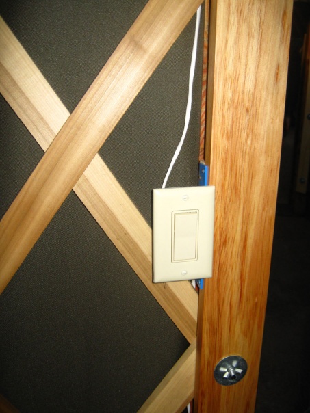

Each 20' yurt has it's own heater and solar panels to charge batteries which power wall switches for 12 Volt lights, circulation fans, & water pump (from rainwater catchment).

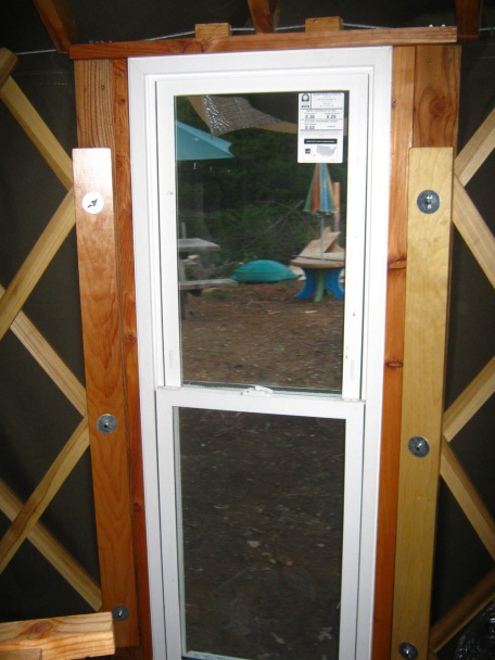

Do you ever think you could build the roof window/panels from tempered glass on some type of piano hinge along one side so they could open and close?

Yes, in fact our latest customer has requested something very similar because she does not like vinyl windows (prefers handmade). I'll get the glass and just build a frame around in and hinge it the way she's requested. Which is at the floor and the floor-to-ceiling window hinges in and stops with chains on either side. There are no actual hinges and the window itself can be lifted out of the channel it sets in and be taken completely out. Could just as easily/affordably place a glass door in that window space...
