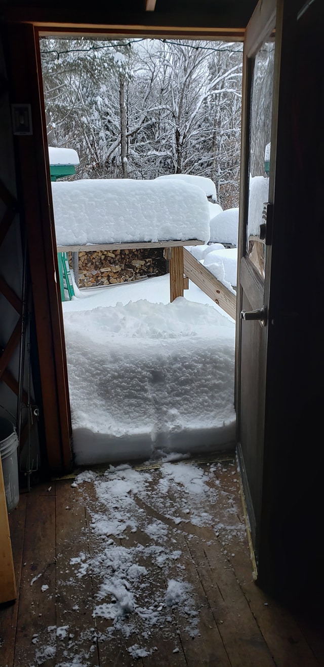

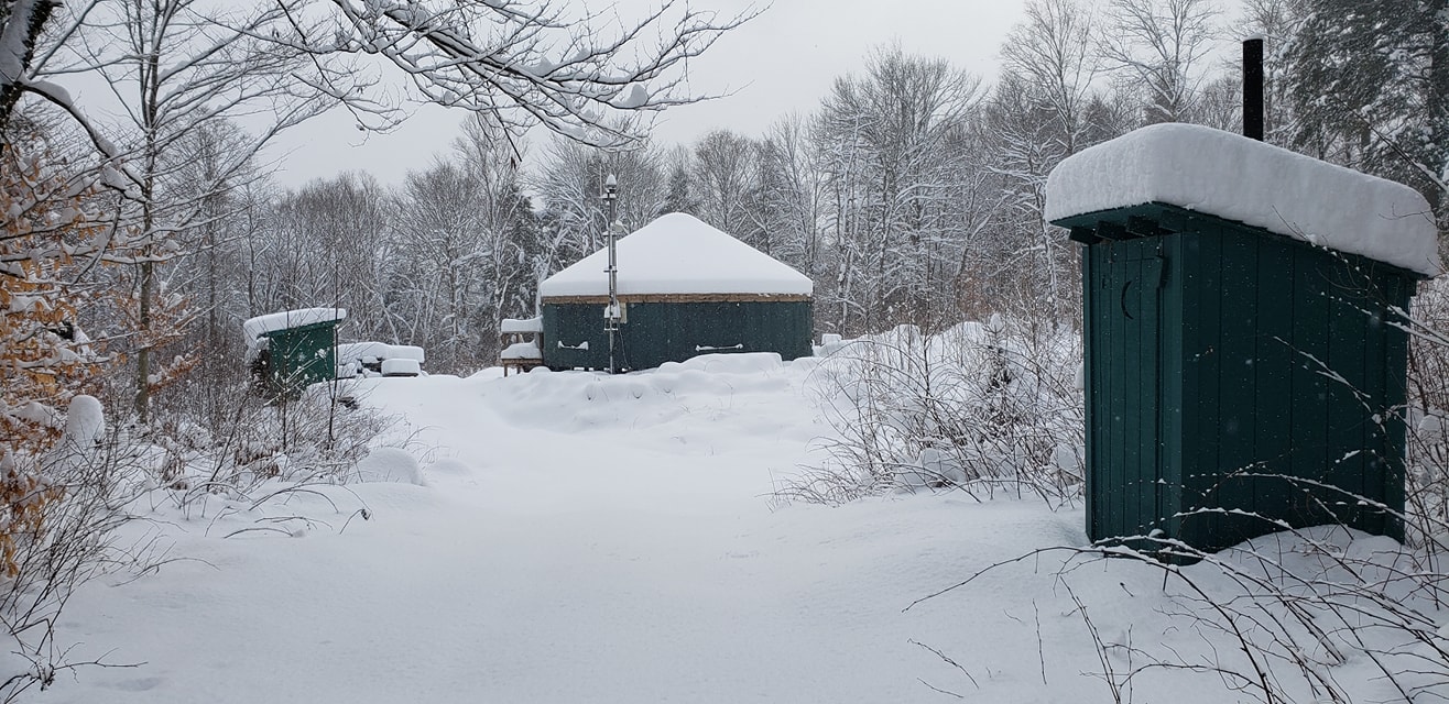

I don't have the numbers now, but when I found the snow load requirements in my area which IIRC was based on snow PSF, my yurt exceeded them without the center pole. We have years where we get snow like that picture above. Of course, I have never let it go the entire season that way. Even in the hardest winters, I have snowshoed or snowmobiled into the yurt and gotten the fire going which cleared the yurt.
This year was more mild when it came to snow load for us up here in Northern Central New York. I have attached a couple pics of one of the times I snowshoed in.
I suppose someday I will be too old to do that and will have to pay someone to do it.
