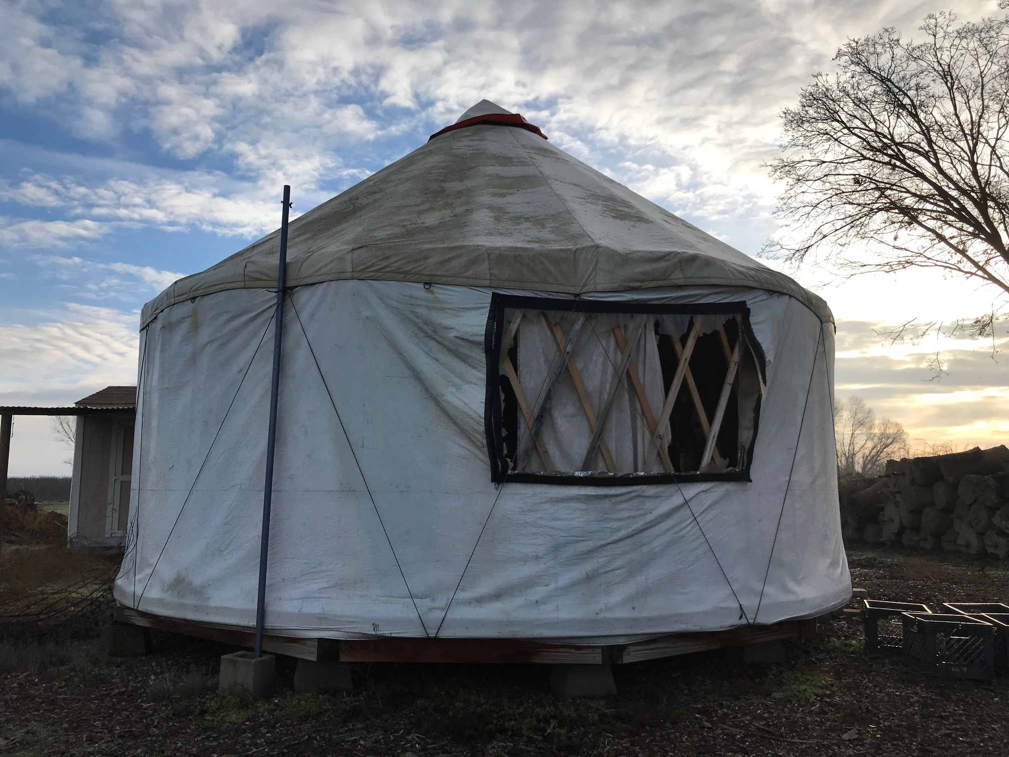

I am so honored to finally post in this amazing community as my wife and I are Tiny House dwellers and have dreamt of a yurt for quite some time. We found a used one on Craigslist and jumped on the opportunity to purchase a 16 footer. I am not sure if it is homemade as their is no identifiable markings of a manufacturer. The ring, rafters, cable, lattice, , door, flooring, beams, and pillars are all in solid shape, however the covering, which is made from used billboards is brittle and needs to be replaced. My wife and I are both middle school teachers, and are interested in taking on the challenge to fabricate covers and save a few dollars.
First, we are in the foothills of Northern California and it is possible we may be putting this yurt at snowline. Can a 16 foot yurt with 2x4 rafters support a snow load? If so, what are we talking?

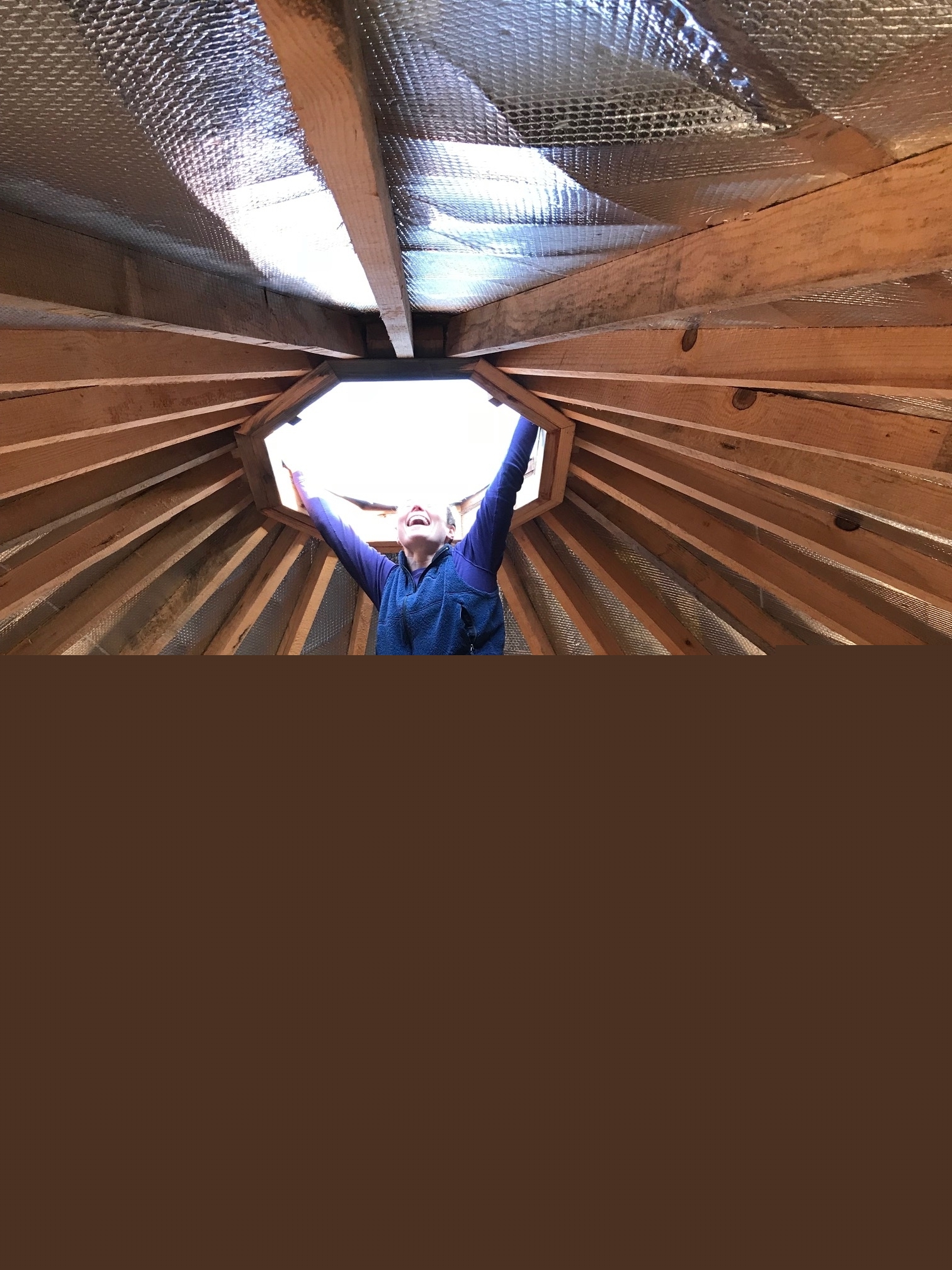

Congratulations on becoming a yurt owner! A 16' yurt with 2x4 rafters can do very well in snow depending on how it is constructed. If you plan to place your yurt in an area that experiences snow I would recommend reinforcing the wood framework. I can see that there are some very large knots in the rafters and sizable knots in the lattice wall that would be of concern as likely failure points that should be addressed. You should also check to be sure the is swaged rather than clamped because this cable is one of the main structural components of the yurt.

Thank you for your response . The dream is to one day have a 30 ft Pacific tucked in the Northwest somewhere. I appreciate your keen eyes and maybe it makes sense to replace the rafters if we decide to be a bit higher up.

Knots are no good, period. Clear 2x4s can be had at Home Depot or Lowes. Replacing laths need to be ripped with a tablesaw. Rip from the clearest 2X you can buy at Depot or Lowes. They will let you dig through the bunk to get a clear ones. Clear ones or lumber with very small pin knots are in there, you just have to look. A regular lumberyard may or may no let you dig. My guess is they will not.
As for cable make sure it surrounds the yurt including over the door. For a heavy load like snow don't use less than a 1/4" cable. I have six cable clamps on mine at the lap and the lap is a foot. Depot sells cable 5/16ths cable and that isn't overkill.
Anchor the yurt to the deck. Put 2x4 supports under the 2x4 rafters and anchor with 'Simpson Strong Tie' hardware, one on each side at the top and bottom. Attach with screws not nails.
Lash your rafters to the wall with rope or tie wire. If wire, double over the wire, lace it around the rafter or through the rafter hole and around the vee at the top of the wall. Twist the ends together. Insert screwdriver in wire loop and twist until the rafter and wall is snug. This makes it completely impossible for the rafter to seperate from the wall. That's a HUGE deal on a yurt.
I can't see how the rafters are attached to the ring but if they are a loose fit with no metal, you can attach those to the ring with tie wire. Drill a small hole in the rafter from below on an angle, pass the wire through and lace it around the ring. Tie off as above at rafter to wall.
You can also make a rope bridle to throw over the top of the rafters outside on top of the cover. Anchor that to the perimeter of your deck.
Yes this seems overkill. But it's your home and by God you better not overlook anything that could let you lose it. In the winter with a 3' snowpack atop that roof you'll be a happy camper, trust me I have been there with just a 1.5 foot snow pack. Plus there are earthquakes and tie wire will stop the yurt wall rafter ring from wiggling apart in a quake, or extreme wind. Good luck. A 16' yurt is wonderful.
