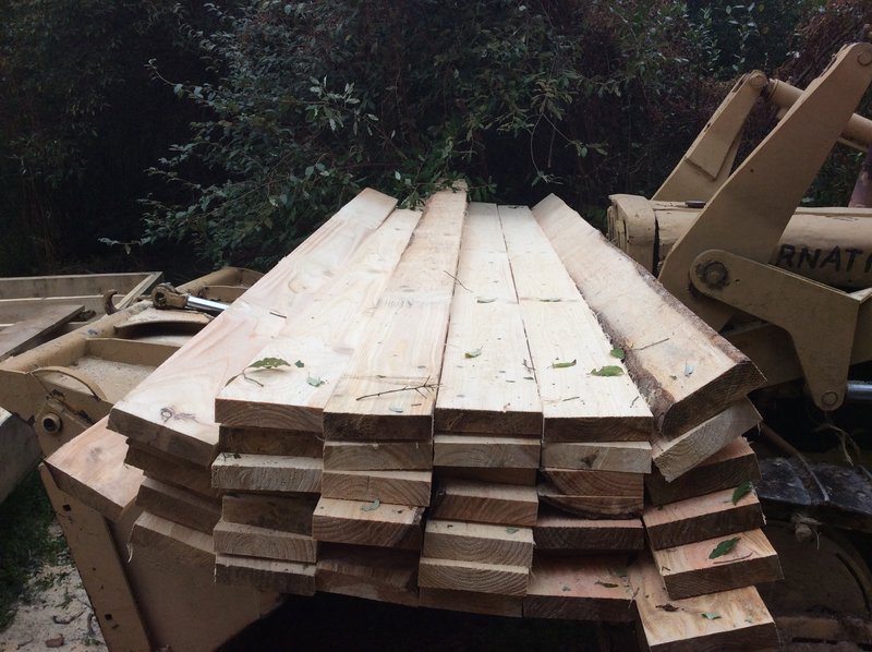

I finished milling the 2x6's for the floor joists. 5 logs gave me over 400 running feet of lumber. Next is the layout...
