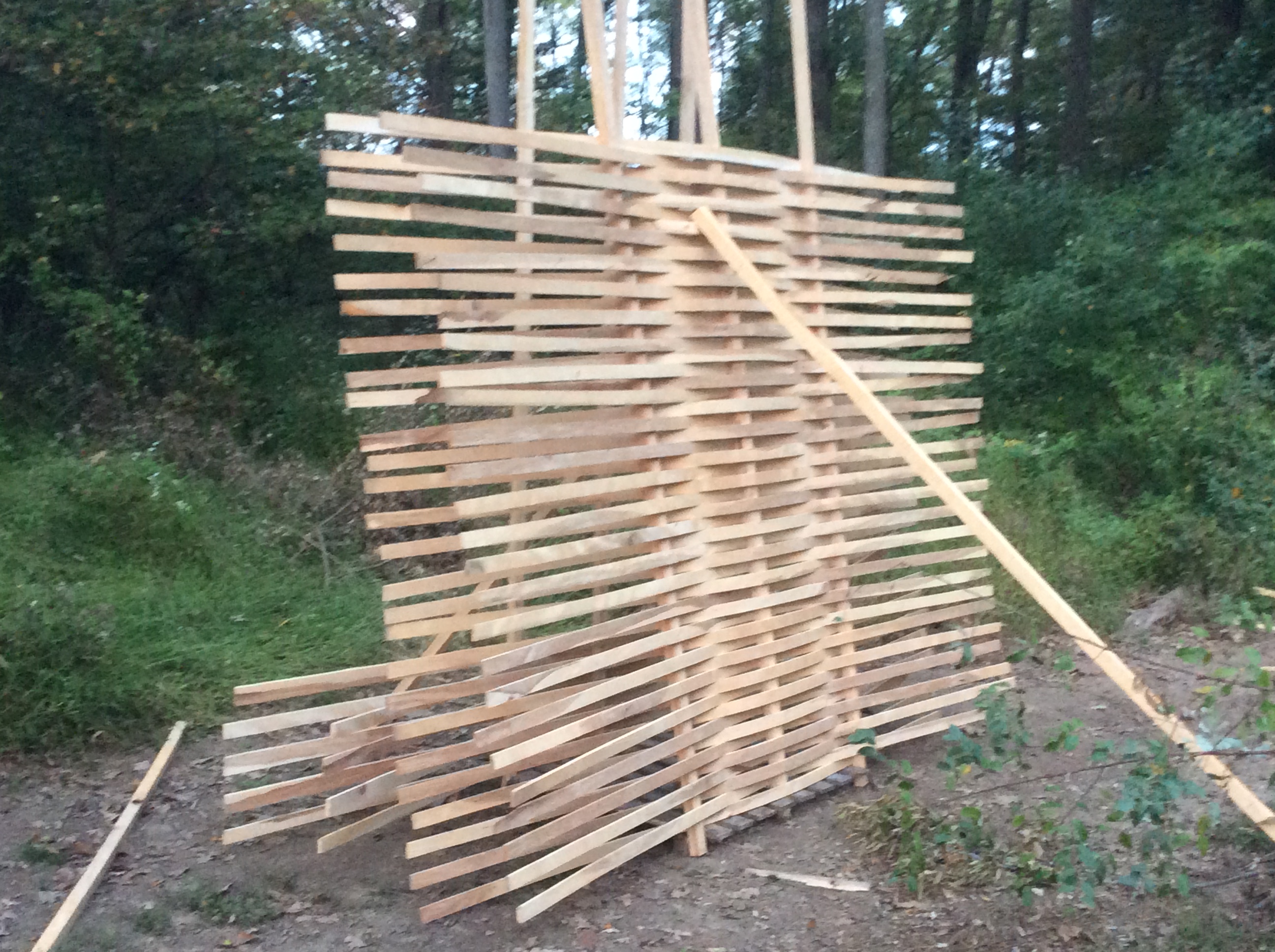

a2 x b2 = c2 This formula will give you alot of unknown lengths.
Bending lath before assembly into wall is absolute essential, if you intend to bend them.
Laths on a 45 degree angle relative to the platform, are at a 90 degree angle relative to eachother. The laths form squares when you look at the wall. This is a very quick reference when expanding the wall sections, assuming you planned on the wall having squares. The wall doesn't have to be squares, it can be diamonds. Your choice. Raise the wall and the diamonds narrow, and the inside diameter shrinks. Of course you need to have this planned out or the roof pitch will change, and the wall cover will beshort. You need to have all that worked out before hand. Diamonds I don't know jack about. My 12'7" yurt is squares.
You migfht want to google: Caln Yama Kaminari Yurt click on yurt build and read the instructions. I have built the 16' 14' and now the 12' version. Good luck.
