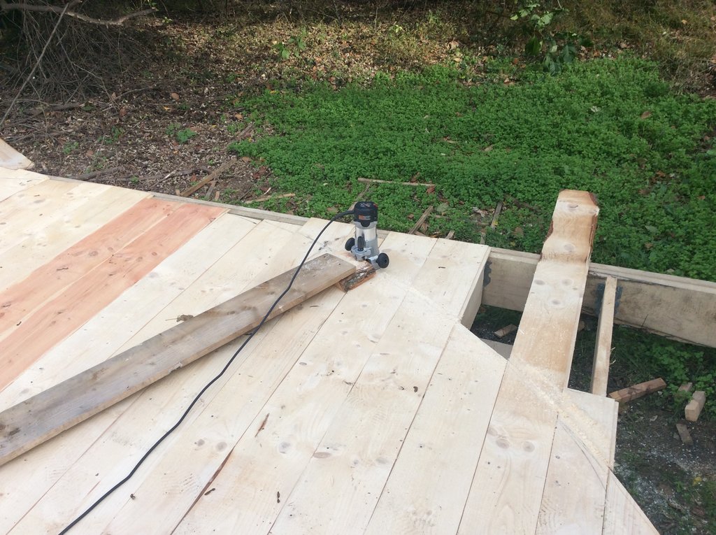

More work on the platform today. The base for the platform is finished. Next I have to cut 2x6's to make the platform. Lots of mill work.
Here is my home made circle jig. It did a great job. Now I can get a feel for the finished space.

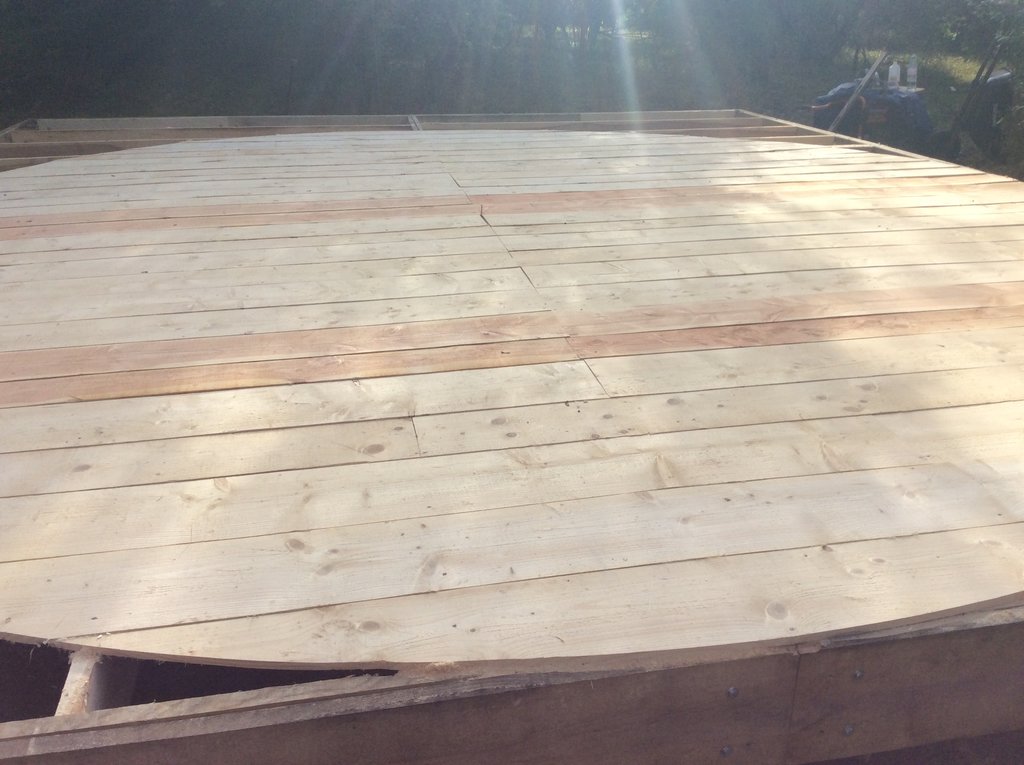

I finished milling the 2x6's for the floor joists. 5 logs gave me over 400 running feet of lumber. Next is the layout...
