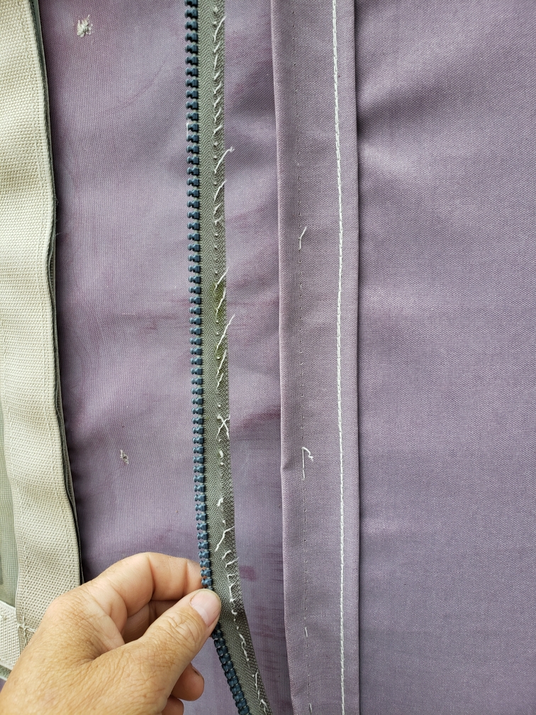

I have a 30' Pacific yurt and the window down flaps that cover the window,
the zipper part that is sewn to the wall is coming undone
any thought on the best way to fix?

I'd resew it using a speedy stitcher. The heavy thread those stitchers use will not break or wear out from using the window. Double sided tape will holdthe zipper in place while you work.

Here is a PDF explaining how..
Here is link to the adhesive:
https://amzn.to/3gxWokz
Here are some different kinds of rivets:
https://amzn.to/38CmX5u
