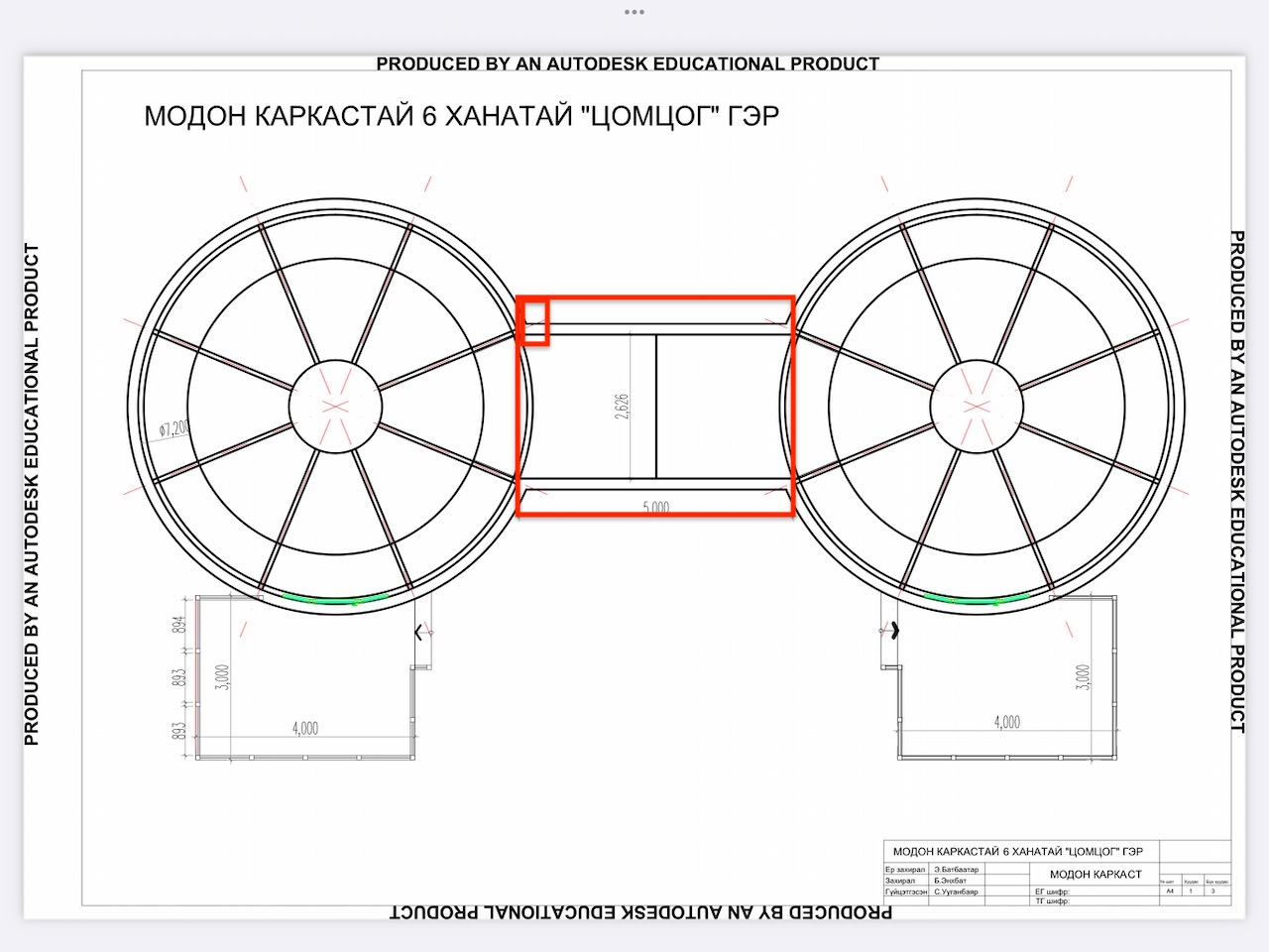

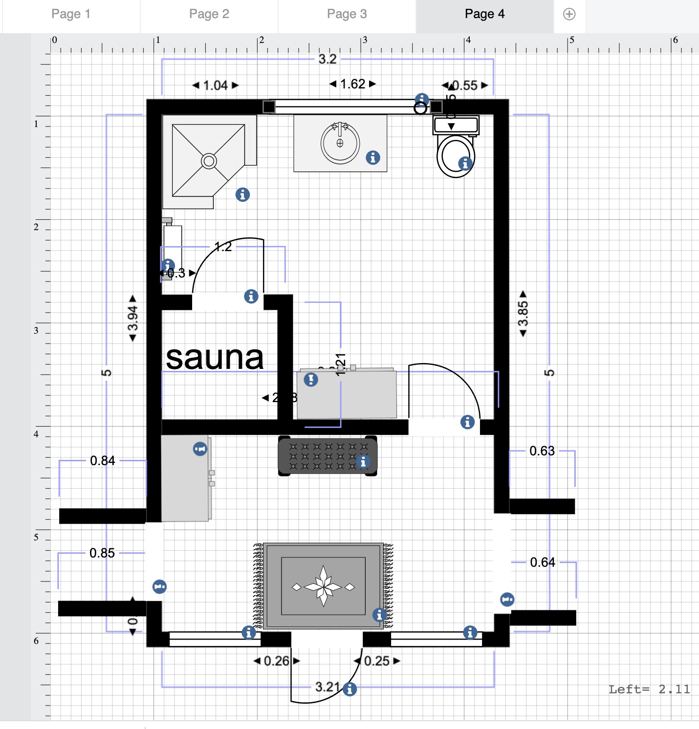

Old 07-25-2022, 10:00 PM   #8
Join Date: Mar 2022
Posts: 118
Default Re: Two yurts connected with a corridor
Hi, we're planning a very similar thing, except in the mountains of Mongolia. We should compare notes but our climates are radically different.
Our twin gers are 7.2m outer diameter with 6 structural curved beams at 60 degree intervals. The connection door frames are custom elements to transition curved walls to straight walls for doors. We have 3-panel main doors for summer but we want the hallway to also have an entry door for nasty weather. That way all the heat won't escape when we enter the hallway. There will be side doors to keep the heat in the gers.
The company who built the gers provided a plan and elevation but we'll probably build it ourselves. They suggested building the hallway with SIP's (structural insulated panels). However, we'd like to use the same materials and style as the gers, so it will likely be the same 4x4 posts with lattices, wool felt
insulation
and waterproof/breathable canvas. I haven't decided on the roof type and material yet. I'm thinking steel sandwich panels with EPS in a lean-to style. That way we can harvest some rainwater in the summer rain season.
I'll try to attach some pics but I'm new and haven't got the hang of it yet. Let me know if you can see them. The first 2 images are what the ger company provided, the third is possible floor plan design.
