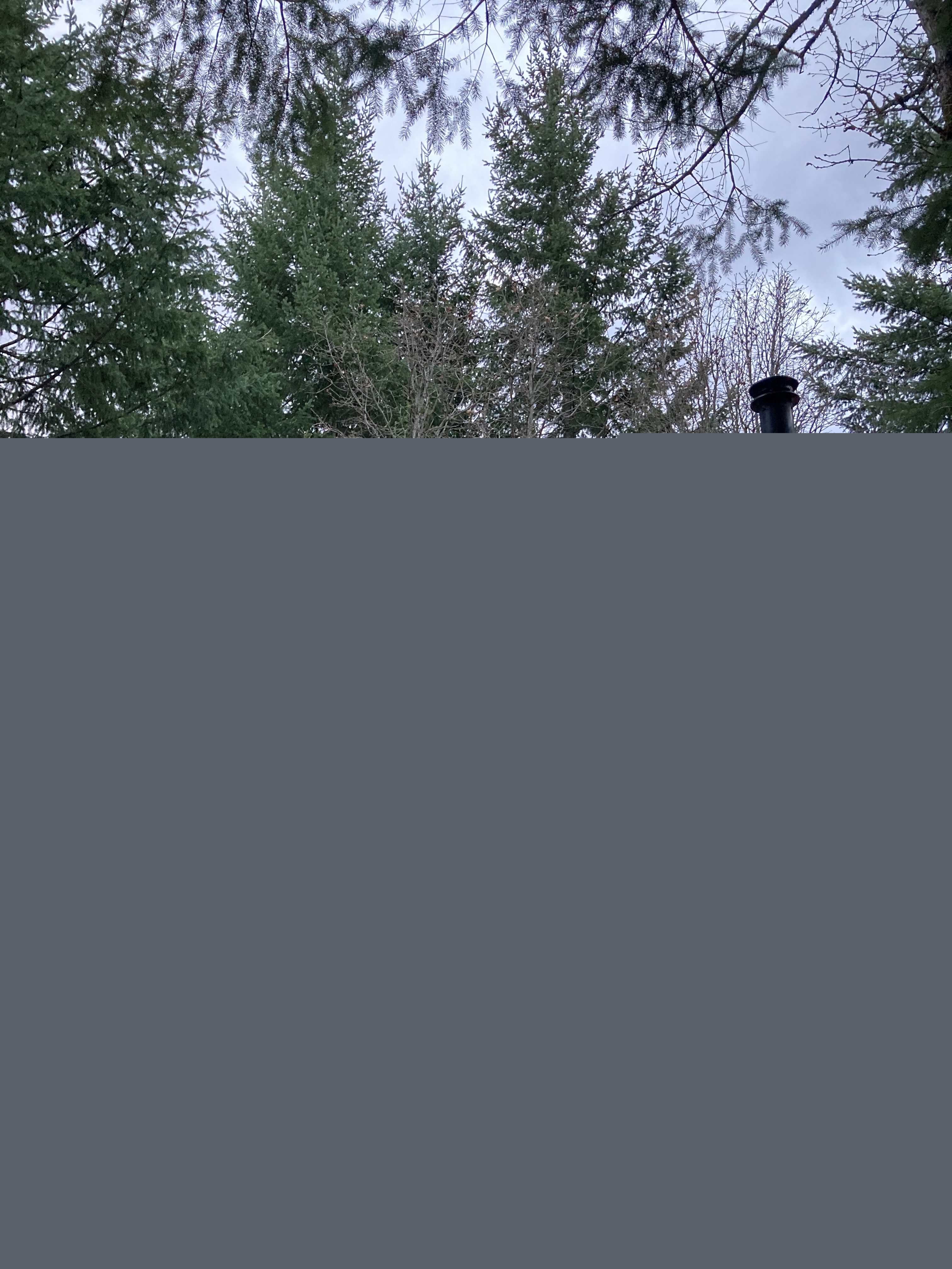

I'm looking for some advice with my woodstove chimney. I recently put the below post on hearth.com but have gotten limited response and think maybe some yurt-specific advice is ideal. I've seen some threads on here around the drawbacks of the double 90 set up in order to exit high on the wall from a rear-exit stove. I'm pretty averse to punching a new hole in the wall at this point... wondering if anyone who's been living with this set-up has it dialed in and if so how high is your exterior stack?
I live in a 30' diameter canvas yurt with a Woodstock Fireview as our sole heat source. It's an awesome stove that generally works great... after I clean the chimney. However, I seem to be getting creosote build-up in the chimney at a pretty fast rate. This is my first time living with a woodstove so not really sure what's normal, but I cleaned the chimney in mid-December, for example, and I think it's more than needs it again already after regular-but-not-super-heavy use for that month and a half. We were gone most of that time and had a yurtsitter who I suspect might not have been running the stove quite right, as it smelled pretty smoky inside when we got home, But apart from any operater error issues, I'm wondering if there are some tweaks I could make to the chimney system that would help. I get a little nervous when it smells like smoke inside that I'm slowly poisoning my family!
A month or two after cleaning the chimney I start to get increasing problems with smoke coming into the yurt when reloading the stove or starting a fire. The last couple days have been super windy and that seems to have increased the smoking issues. Apart from the general hassle of cleaning the chimney, it is extra annoying in a yurt because the structure doesn't hold heat very well - in winter by the time the stove is cool enough to clean, the yurt can be freezing inside! We pretty much have the stove going non-stop from late fall to early spring. So anything I can do to extend the cleaning interval would be wonderful.
I'll attach a couple pictures, but basically, single-wall stovepipe comes out the back of the stove, 90's up, runs vertical a few feet, 90s out the wall into a T and then runs up 10 feet of double-wall to a cap. The two things I'm suspecting might be issues:
- Is the 10' main stack (plus the 3' of vertical single wall inside) enough height, given the two 90s and T in the system? If not, how much should I extend it?
- Would it be worth upgrading to single wall pipe for the interior run?
My guess is that I just need to add more height to the chimney, but since that double walled ain't cheap, I thought I'd get some opinions before I try that. Any thoughts on the above, or anything else I might be missing would be greatly appreciated!

It is very unusual for the chimney to require cleaning that often. Your chimney is the typical height, and if you are only burning seasoned dry wood, it could very likely be the number of ninety degree turns in your piping. I'm not sure if extending the chimney would offset it or not, but a stove specialist might be able to provide that answer. I suspect that eliminating some of the ninety degree bends would also help with this issue. Since your stove is a rear exhaust, you could penetrate through the yurt wall directly behind the stove (lower than typical, but still workable). This would require not only patching the hole higher on the wall, but also lowering your chimney to align your cleanout tee with the pipe coming through the yurt. Installing the stove flashing that low on the wall would also require the use of some silicone caulk to prevent water draining behind the flashing.
Exiting low on the wall could potentially require an extension of the chimney, due to most codes requiring the top of the chimney to be two feet above any portion of the roof within ten feet of it. Hope this helps!

Adding another section might help. I turned my 90s into using 2 45s and that seemed to help.

Thanks for the thoughts Pacific Yurts! Yeah, no doubt going straight out the back would be the best set-up, but I am a bit loathe to punch another hole through the wall at this point! I might try adding a little height to the stack and replacing the interior piping with double-walled first and see where that gets me...

Hmm, I believe it is 4 sections of that double-walled pipe.
