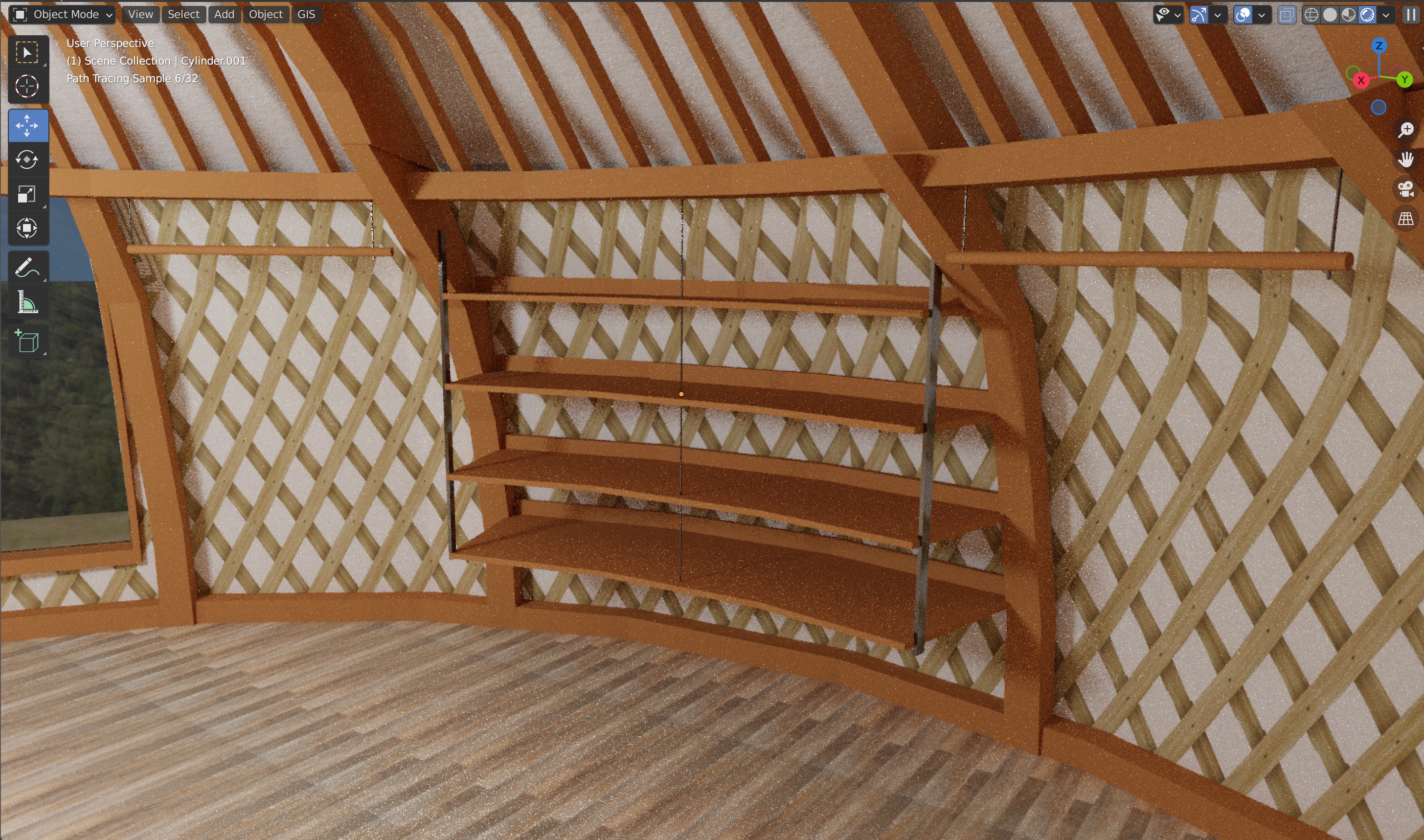

This is the simplest idea with different depth shelves depending on the vertical position on the wall. The shelves are just supported at the edges by the posts of the gear and the middle ring above. The wood could be MDF or similar and the hangers, threaded rod and nuts.
Name:	01 simple shelves.jpg

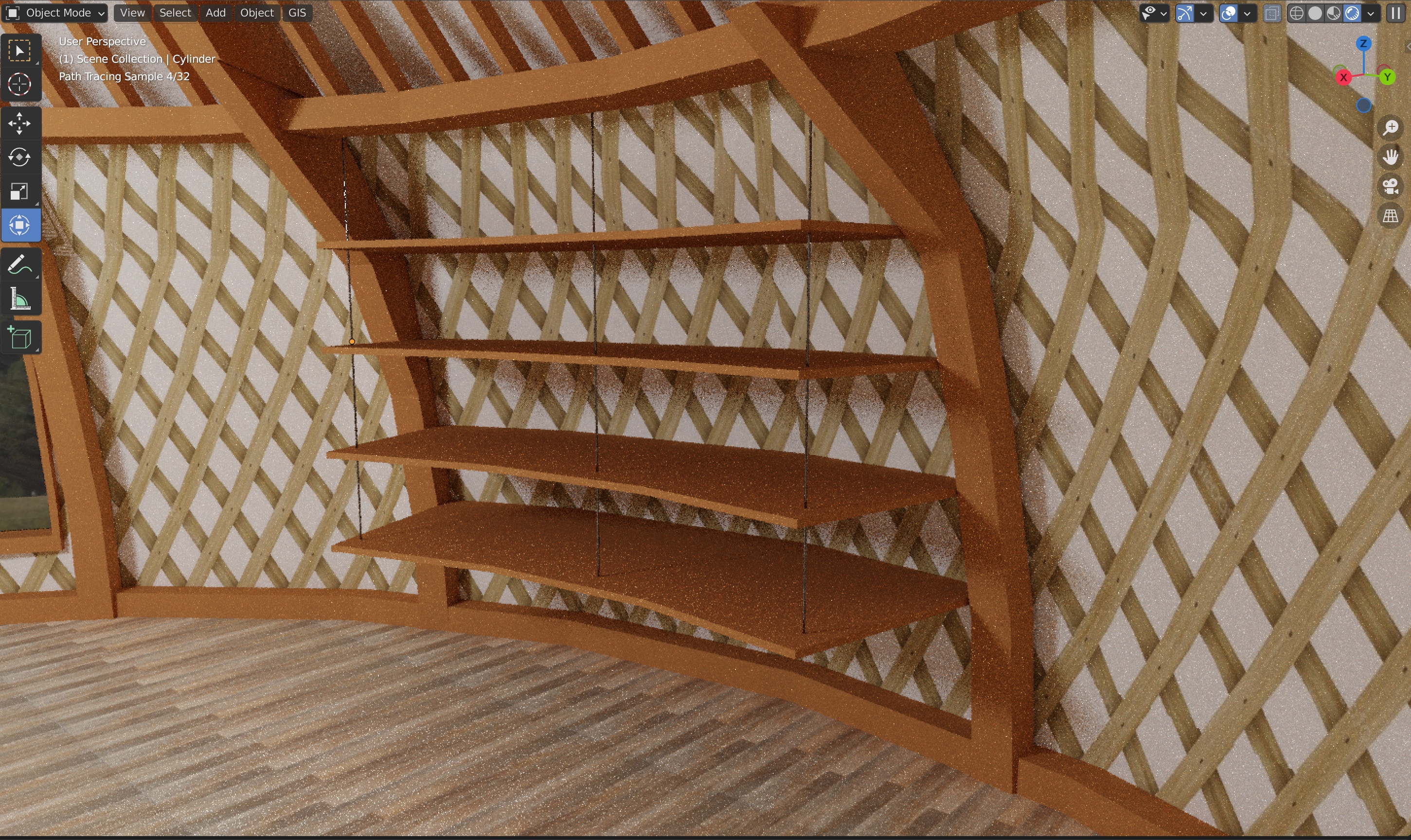

I thought about the hanging system and they threaded rods might be better replaced by flat steel bar with holes. Except in the middle. Also, simple clothes hanging rods (thick dowel) can be supported from above too.
Name:	02 shelves and clothing rods.jpg
