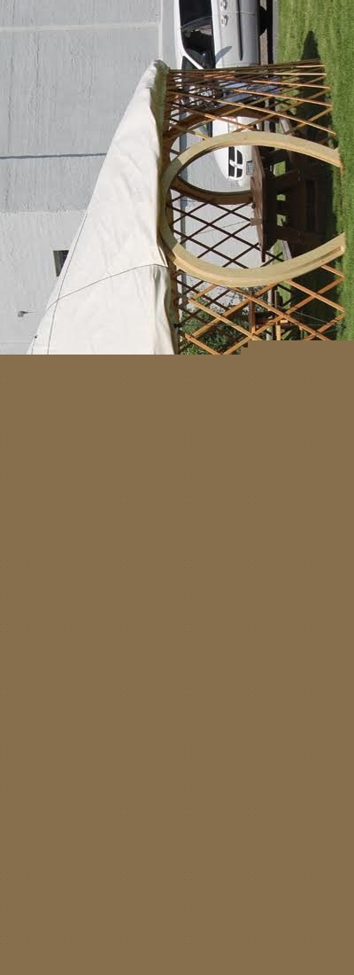

IMO 30' and 40' yurts are inappropriate for festival as they are WAY the heck too big, unless you have a number of roadies to help you erect them. Two smaller yurts in the 20' range would be a whole lot more doable.
As for various yurt diameters, say 6 to 7 meters, traditionally those are a series of khana expanded, lapped and lashed together at the laps. You can add or subtract panels for various yurt diameters.
Forget 'latching' them that's reinventing the wheel. You could go three, four, five, six panels etc. You could have three rings, each with appropriate holes or slots for various yurt diameters. I'd go with a rafter on top of each lath cross, just like Mongolians do. I would 'not' have a slot in the rafter that lays on a cable. Buts that's just me.
Canvas yurt cover, good luck I have no resource to suggest. If you want a long term bomb proof cover, the manufacturers on this site might be able to help. Good luck.
