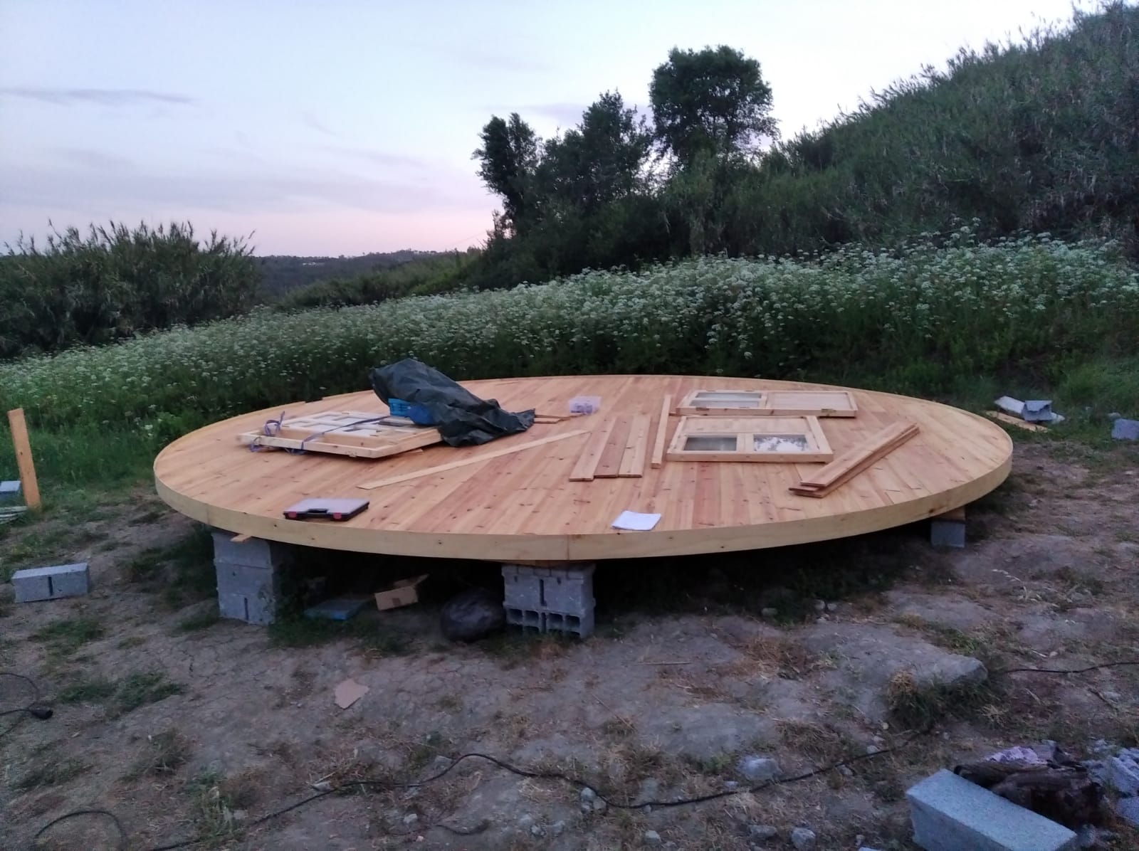

Ok that's clear! Thanks for replying. What makes you say definitely?
The second part I don't fully understand.....you mean raising the vilt a bit above the floor? My deck is a circle so there is no floor beyond the drip edge. Wait I'll add a picture

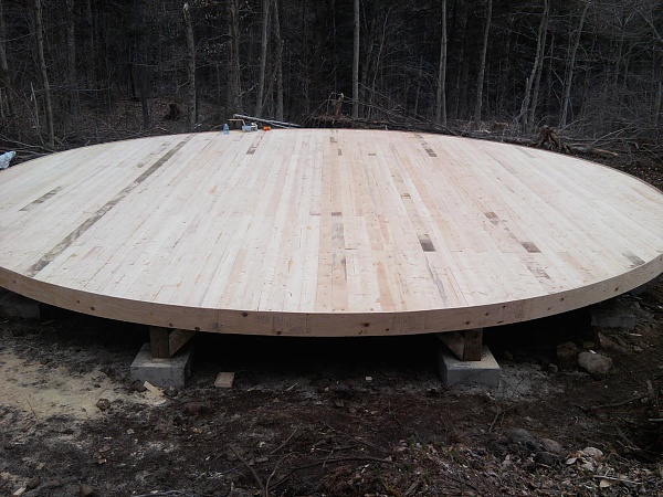

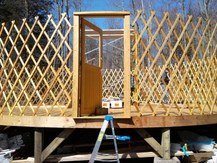

Oh, you should be good then as far as clearing the ground. What usually is done, is that a skirt of bended plywood is put around the edge of the platform and the lattice bumps up against it. It keeps the lattice from sliding off. You wouldn't want the felt between the lattice and the skirt. I hope these images make that clearer. Notice how you cannot see the bottom of the lattice in the second photo? It is because the skirt is raised up about an inch above the level of the floor.

calcetines my deck is like yours. Overhang, no skirt. For photos, copy and paste on google images:

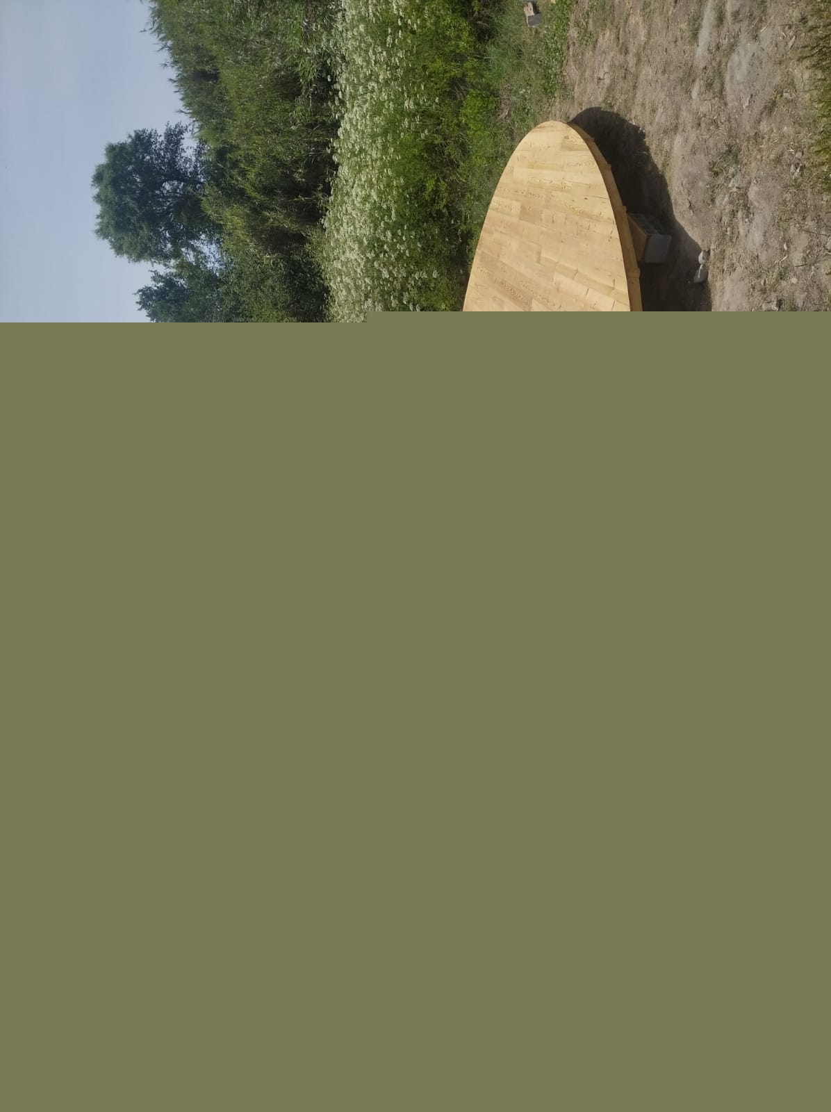

Nice deck Jafo, I'm made a skirt like yours. You say "you wouldn't want the felt between the lattice and the skirt"........what is the reason you really wouldn't want that?

My sticks out one inch above floor level and covers the side of the floor and the supporting beams, being 5,5 inch in total

Because then the lattice wouldn't sit tight up against the skirt. Also, if the felt will go past the top of the floor and overhang, which is a better seal than butting up against the floor itself. You can either cinch it to the deck or screw it to it, as I did with mine.
