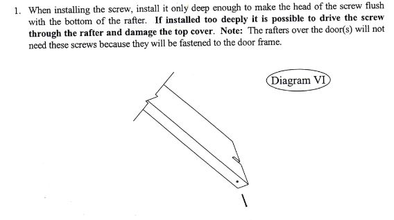

I dunno if this matters or not because I don't build these things, but on my Pacific Yurt, they join the cable ends right above the door. There is a slot that receives the cable on the end of each rafter. Once you set the rafters in place, your run a screw through the width of the rafter, on its end, behind the cable, blocking it from coming out of the slot. I hope that made sense lol.

Here it is from the PY manual:

Thanks, it's an interesting solution, but it seems to me like that way the cable doesn't really help the walls much, as it hangs on the rafter ends...but maybe I'm wrong. Or does your yurt have the rafters laid straight on the cable between the wall lath crosses? I saw some modern yurts had that, but I'd rather use the classic way and lay the rafter on the crossings.
