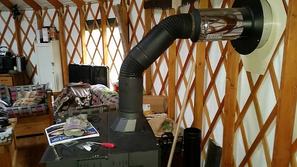

BTW, here is my updated stove pipe:

Nice. Putting a pipe through wall makes some things much easier, though it requires well prepared wall section for that.
