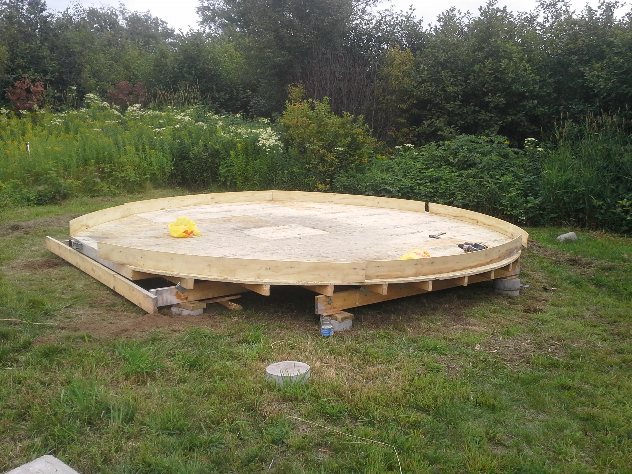

(Hope the picture that I attached is visible) This picture shows how I managed the interface between the floor and wall (lath not up yet in the picture). The fascia (is there a better term for what that is?) is attached to the 2x4s and floor boards and provides a "rail" to catch the wall lath, holding it nicely to the circumference of the yurt and a nice solid surface for the yurt cover to lay against, which is then held in place by the bottom ratchet strap.
