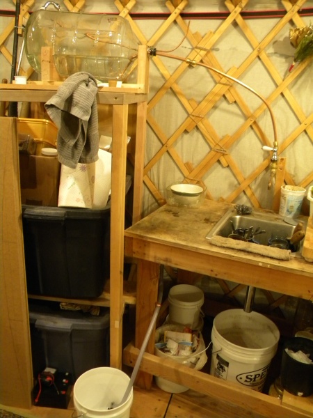

So I too have started to get water wicking from the outside to the inside--doesn't look so great. My layers (outside-to-in) go: snow, ropes, natural canvas, wool fabric
insulation
, liner, lattice. I mainly get the wicking at the upper belly rope & at the end of the roof poles (ie, places where the fabric layers are compressed together). You can see it in the upper right of this photo:
Interior humidity is pretty low due to high air infiltration (I estimate 5-10 air changes each hour). CaCl dessicant set out doesn't capture much if any
moisture
I kind of regret not having tyvek under the canvas now. Also, having an outermost layer of lumber wraps or such would likely also help (getting the snow to slide/run off instead of melt into the fabric). Given my canvas isn't that old (1-2 years), I'm surprised it's leaking--but then even high-tech 'waterproof' camping tents wick water through their layers...
Blueberry, what kind of yurt do you have? What layers? Has the starbright waterproofing completely eliminated the problem for you?

We have a Blue Ridge 20 foot yurt that we bought used. Our layers go (from outside to in) snow, 50/50 cotton polyester blend canvas with acrylic finish, liner, lattic, and denim insulation. The starbright product has not completely eliminated our problem but we do see a difference. We feel like once the weather breaks we will be reapplying and will probably spray on a heavier coat this time. I took some pictures on my phone but I couldn't figure out how to upload them. ( don't know how to find the URL? ) When I put my hand behind the insulation I feel
moisture
on it. One would assume that it would evenitually mold which is a worry but this is all new to us so not really sure what to do. Once warm weather comes I am sure we will do further inspections. We do not have a gutter system so in the next day or so we are going to try and cut some pool noodles in half length wise and put them under the roof hang in hopes that it will help the water drop off instead of running down the sides of the yurt. By the look of your picture it doesn't look like that would be an option for you. But once we get the noodles in I will post on how it did or didn't work! : )

Blueberry, thanks for the details. It sounds like you have a good plan. Hope you guys are staying warm and there's not too much snow on your yurt.
The wicking got bad for us this last week--there was a line about 1/3 around the yurt wall at the upper belly rope, plus two spots on the roof right near the bed/wall that started to drip water amongst other areas. I knocked off most of the water on the yurt (hanging icicles, ice on the edge of the roof, and all the reachable snow). Then I got my masonry heater a little over-fired and ran the propane on medium as well--got up to 75, maybe 80 F for a good half day. That dried things out, at least until the next snow...
