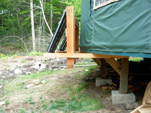

Ok, I decided to put out three 2 X 4's with 3 upright supports all attached to the footings underneath. I still have to doll this up a bit, but much of the frame actually came from the pallets the yurt was shipped on! Why waste them?
Here is a shot from the side:
And here is a shot from the front:
The 4X4 above the left panel was a goofy idea gone wrong.. I have to remove that. I still want to brace the upright to the side (that is connected to the footing) and then I want to support each side back to the footing. I just ran out of time and wood today. I attached the panels with nylon rope. There will be times when I want to move them, so that will make it easier. In the winter when I won't be there as much, I will untie the bottoms and tie the lower half of the panel all the way back toward the yurt wall so when the snow comes off the roof, it doesn't land so much on the panel.

Did you get another set of PV panels? In the previous photo, there were only three and now there are six.
I think it's a great idea to move these from hanging off the roof to having their own support system connected to the deck frame. I don't understand what you mean about tying them back in the winter. Are you saying you will simply pull the bottom back so they will sit vertical instead of with the bottom angled out? Have you though about some type of disconnect system so you can just put the panels inside in the winter or is the idea to have them charging (if possible) but just not tilted out so the snow won't hammer down on them?

Yes, bought another set today. Harbor freight had them on sale from $229 to $189, and I had a 20% off coupon on anything, so I got it for $151. I find the one set works fine if you are up there only on weekends and they recharge the rest of the time, but I plan on staying up there for a week soon and want to make sure I have an extra boost of power.
Yes, I do mean lower the bottom so it will be parallel with the wall of the yurt. I worry that in the winter the angle might be too much if the snow landed on it. I do plan on hiking or snowmobiling in there in the winter so I want to keep the batteries charged up if I can. :)
Hey, that looks beautiful to me! Maybe a titch over-built, but my vote goes with solid over sleek anytime.
Is that all screwed, as it appears, or did you bolt anything?

All of it was screwed with all weather (coated) screws. Nice pics of the raised garden! We have used the pallets for a lot here lol. Even the wood that gets busted beyond recognition gets used as kindling.
