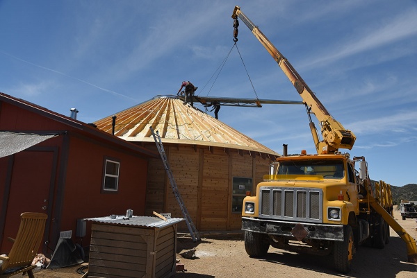

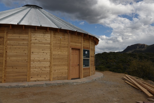

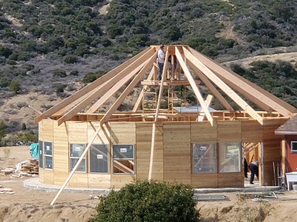

We are almost finished assembling our 41ft yurt from Smiley Wooden Yurts, and are quite satisfied with everything. For those commenting about pricing- SWY tells you to expect final costs to be 2 to 3 times what you pay for the kits. We ended up on the lower end of that...
The quality of the lumber was good - the pieces fit together as well as expected, and they helped through the entire design ordering and construction process. We are satisfied customers... We are just now getting ready to hang sheet rock and cannot wait to move in!

Ok - I am not sure how to do so, so added a few in the construction gallery.
I linked afew of them here.

Looks good. That's a big yurt and a beautiful location!
