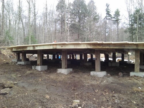

What sort of foundation did you end up using? To be permitted as a permanent residence we have to have a frost protected foundation, so that means either pouring concrete footers or attaching tie-downs to the usual deck. because we want to do this right and make it last, we'll be pouring footers. I'm not sure how this is all going to go, as we are also completely off-grid and plan to stay that way. I suppose we can rent some tools to make the job easier, but they will have to be gas powered. You said you used a generator - do you own one, or did you rent it?
We drove rebar into the ground and then cemented block around it:
You can see the entire process here:
Yurt Forum - Jafo's Album: Yurt Construction
