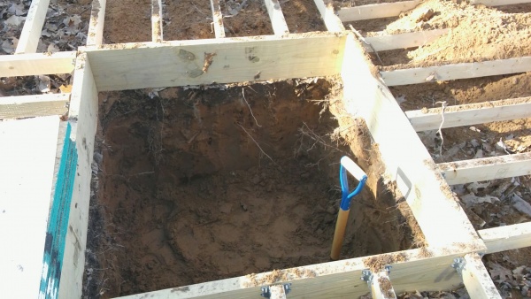

Currently I am working on building the platform. It will be an octagon frame with the OSB subfloor/tongue and groove flooring made into a circle followed by skirting around the exterior.
The center box will provide extra support in the center for the yurt poles. I am undecided whether I want to pour concrete in the middle for the wood stove to sit on... thoughts? The other option would be to turn it into an in-floor storage compartment?
Due to the unseasonably warm weather, I was able to get all posts cemented in the ground today. Next step will be to adjust everything to be level. The 4x4s are all treated lumber, the floor joists are not.
