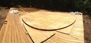

Laying the joists for the subflooring
Actually had to rotate these sub flooring boards. Learned it is a nominal width so it wasn't lining up on 16" on center. Had to remove 4 boards then start over. The insulation was rained on in one spot when the wind blew up my tarp but I let it dry for a week and seems to be fine. I did not end up laying house wrap on the bottom as I did not want it to hold water and figured it would breath better under there this way. We will see if that was a mistake or not.
Complete square. I didn't count but I think I used less boards than the plan called for by reusing the left overs from other cut boards.
And then it was round. I drew my circle twice in one spot and on about a 5' section I sawed the wrong one making it to small. I figure when I cut my finish bamboo flooring I can cantilever that extra 1-2" out to make my perfect circle and should be fine. We will see.

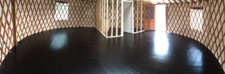

Damn near had heat stroke. I was drinking water so quick I wanted to puke but by 1500 I had to start cleaning up as I had a headache, the shivers, and was lucky to piss the little bit of orange I did. Even flying in 120 degree heat with full flight gear and body armor in a black helicopter I had never been so hot. That tar paper and black flooring was miserable. I have to do it in the morning and evening to finish in the shade. I need a sharper or more teeth on my saw blade to cut the bamboo without it blistering. Maybe a jig saw this time I don't know. Also the flooring bubbled where the vapors were trying to escape out of the cheap pain on top of the flooring. It was the cheapest flooring that was not laminate that I could find and my wife helped decide but I think she is going to hate the dark dark brown/black flooring with all of the dirt that it shows. We shall see.

So I haven't had a lot of time and in fact I should be sleeping so I can get out to the site early tomorrow morning but I wanted to update the build. Last Saturday I went out and the bamboo flooring was ruined due to water that seeped past the tarps and was trapped all week. Would have been better without it. Decided to rip it all up and finish the platform. The moved on and finished 90% of the 30' platform by myself before heading home. On Sunday one of my friends came over around 0900 and by 1800 we had one entire yurt up. Only needed one other person to help get the ring up initially and later on to help get the roof through the center ring.

Just a few pictures. I managed to install all of the bamboo flooring, get the interior walls up, installed doors for the first time (tricky), painted all of the cabinets, made a counter top, finally built stairs, cleaned up all of the trash from the previous tenant, mocked up the AC units, and placed all of the appliances in. Whew.
