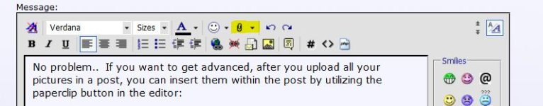

No problem.. If you want to get advanced, after you upload all your pictures in a post, you can insert them within the post by utilizing the paperclip button in the editor:
Like I just did ^^ :)
