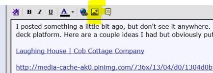

If you guys press the picture button:
And enter the URL to the picture, it will show up embedded into your post btw. :)
