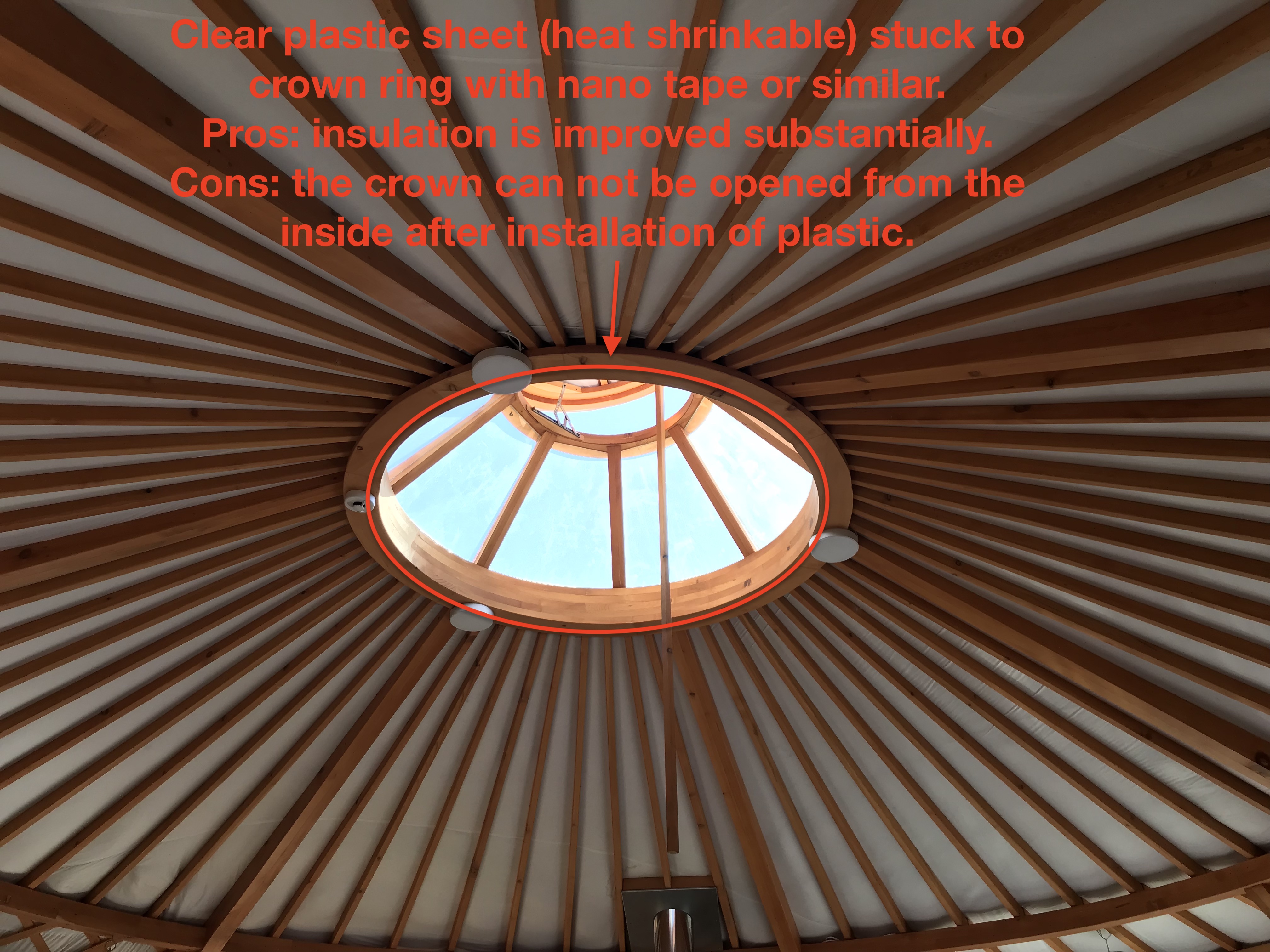

In our situation cold is the main enemy. I imagine it gets cold in Cumbrian winter. So, in addition to what others have suggested - good suggestions for rain, I'd consider the plastic on the inside. The plastic could be stuck to anything and tightened with nano tape. Some types of plastic can be heat shrunk to make it nice and tight for maximum visibility.
The downside is you may not be able to operate the opening/closing of the crown. However, we could still open ours from the outside but it's probably very rarely necessary.
A photo of your crown would really help. I'll show you mine with some notes. It's a modern yurt, not traditional.

Like I said, this is more of a winter cold solution which may or may not work for you. I've done this on windows in Mongolia in houses/flats and it increases the
insulation
of windows considerably without affecting visibility much. I haven't done it to our yurts yet BUT winter is coming, so I might do it this year.
If you´re using an electric opener the problem is solved, isn´t it?

However, I can't think why you'd want to open the crown when it's sealed inside with plastic. We could open hours from the outside too but it's awkward. We'd probably just keep it closed the 9 months of winter where I live. It snowed a bit today.
