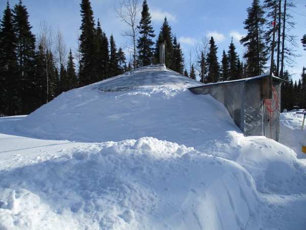

I'm in Northern Ontario and have lived in a 22ft Groovy Yurt for 6 years. We average 4.5-5 bush cords per winter. 70% of that is spruce, 20% poplar and 10% birch. There is a very noticeable difference when we have a good berm of snow up against the walls. Wood consumption drops considerably.

Berm?!? No disrespect, but I’d say you are 1/2 way to igloo territory! Lol. Awesome though. Maybe that is something to consider when designing a yurt in cold areas, a lower platform.
