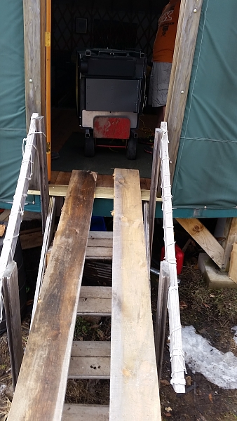

Now it is time to wheel it in there. First, we laid the hand truck on its wheels, and we tied it off to a stud in side, just in case it should come flying back for any reason. My one son pulled with the rope, my other son pulled the hand truck, and I pushed it up.

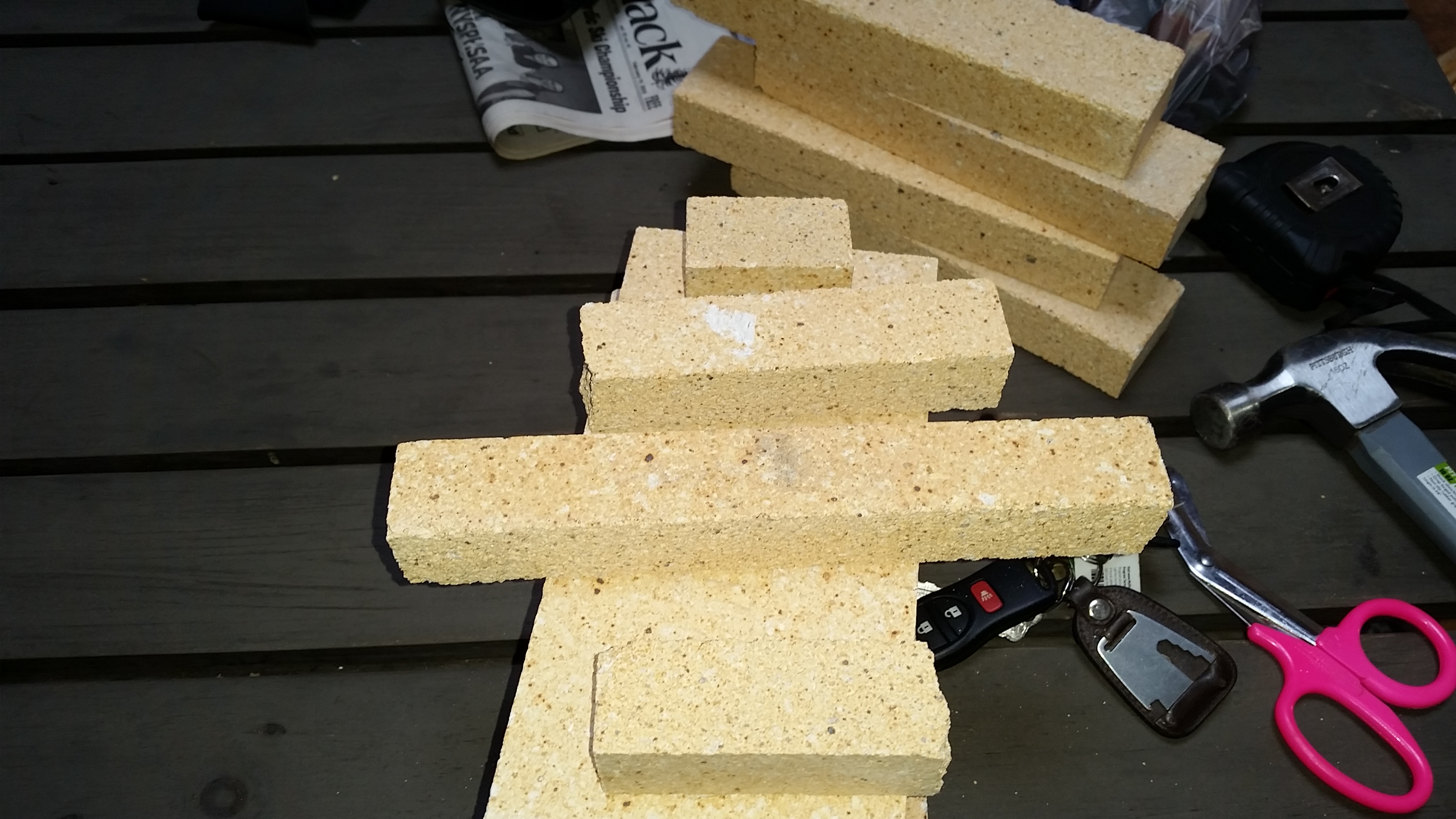

Well, so much for the soapstone being hard to get out lol. Some fell out when we tipped it sideways, and I left two small fire bricks in there by accident. The one small brick actually broke. No big deal, but should have been more careful.

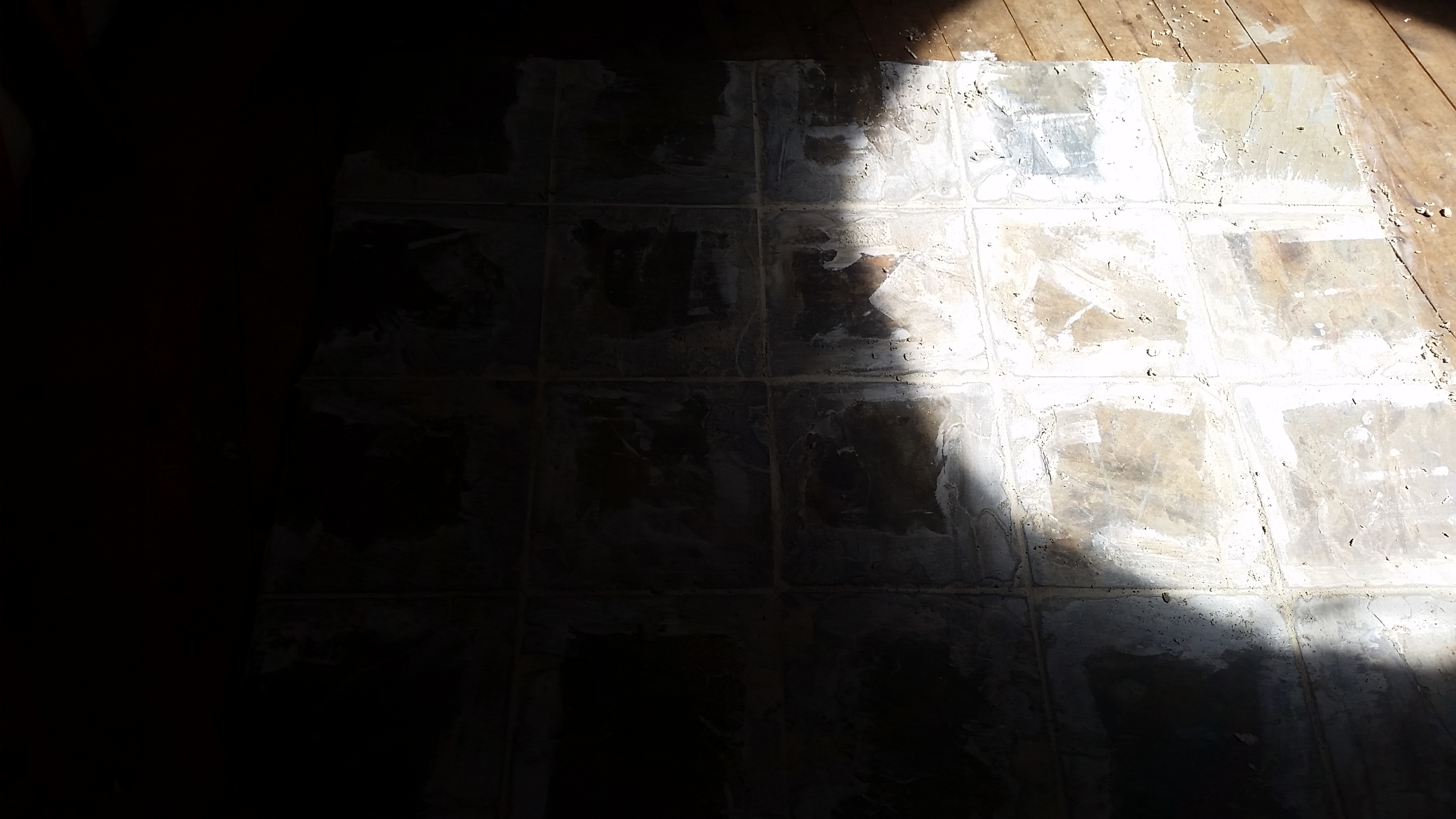

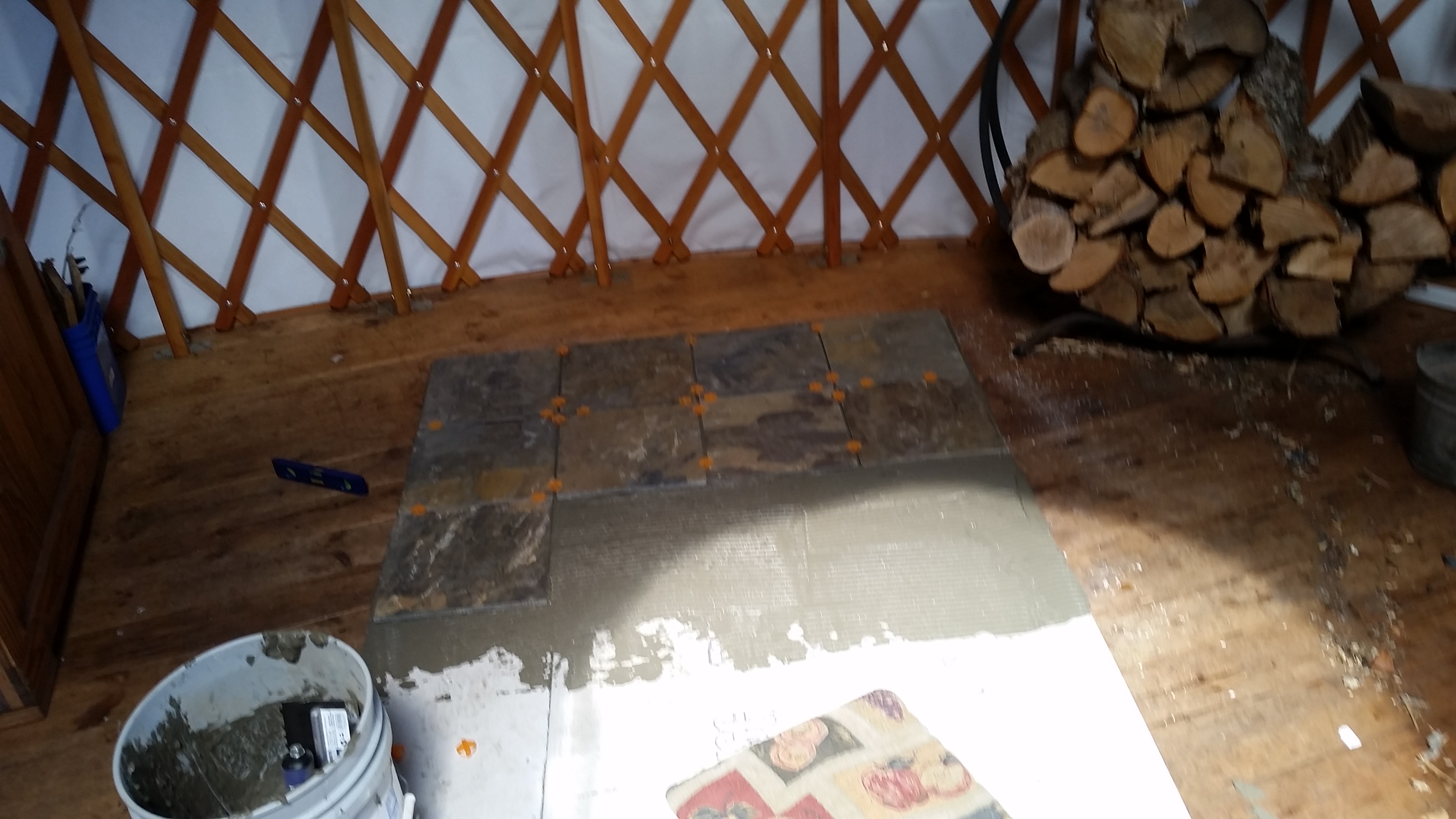

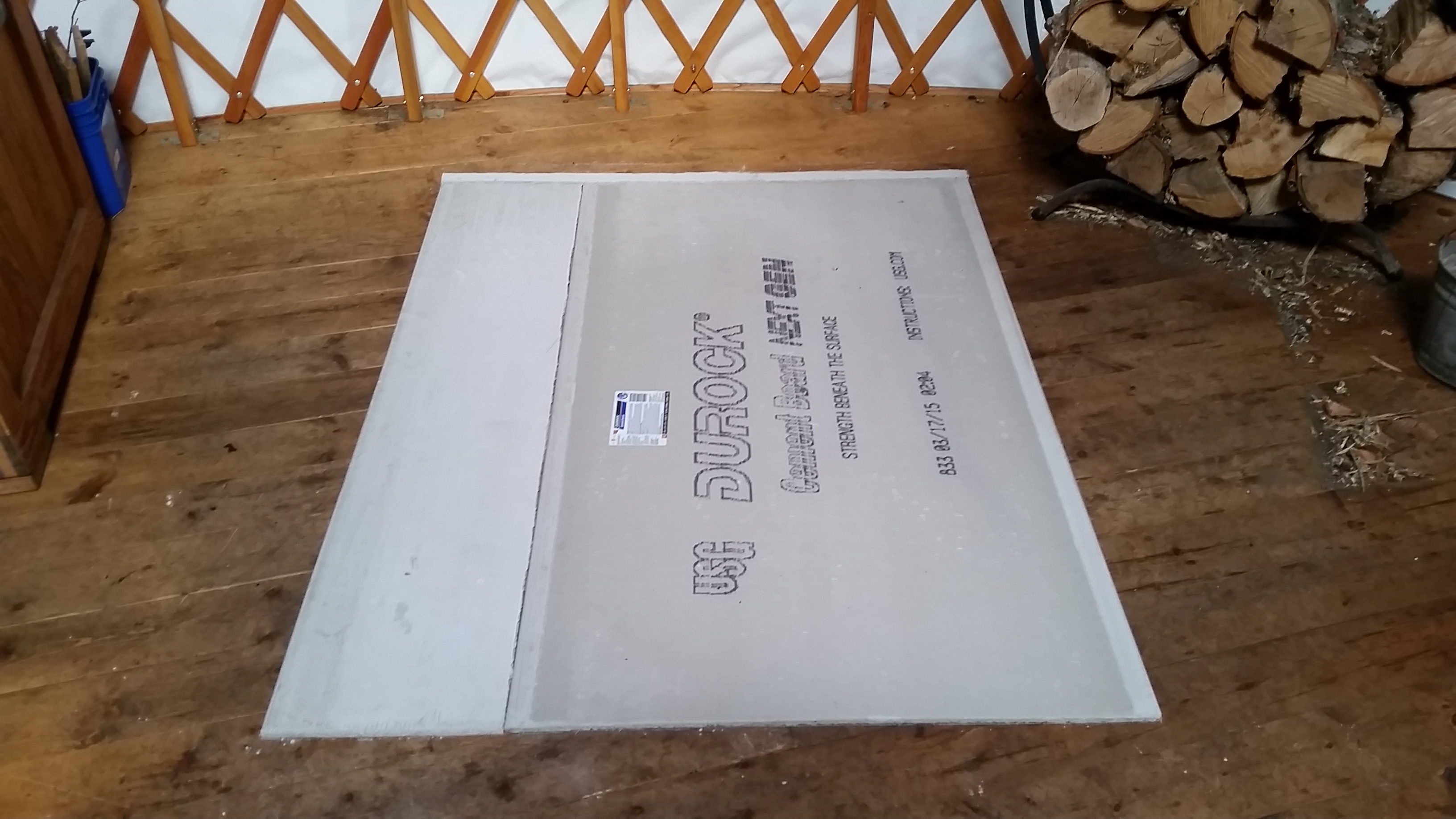

On the second day, I took the old wood stove out and began working on the hearth. This meant I would be "roughing it" that night because the temps were to get down to 28F. I still had other camp duties to do, plus an unscheduled stop to the local hardware store as I brought the wrong thinset with me. However, I did get everything done.
Good thing I remeasured here. I had a brain cramp and for some reason thought I needed to make the hearth 13 inches longer than necessary. That's why they say to measure twice.

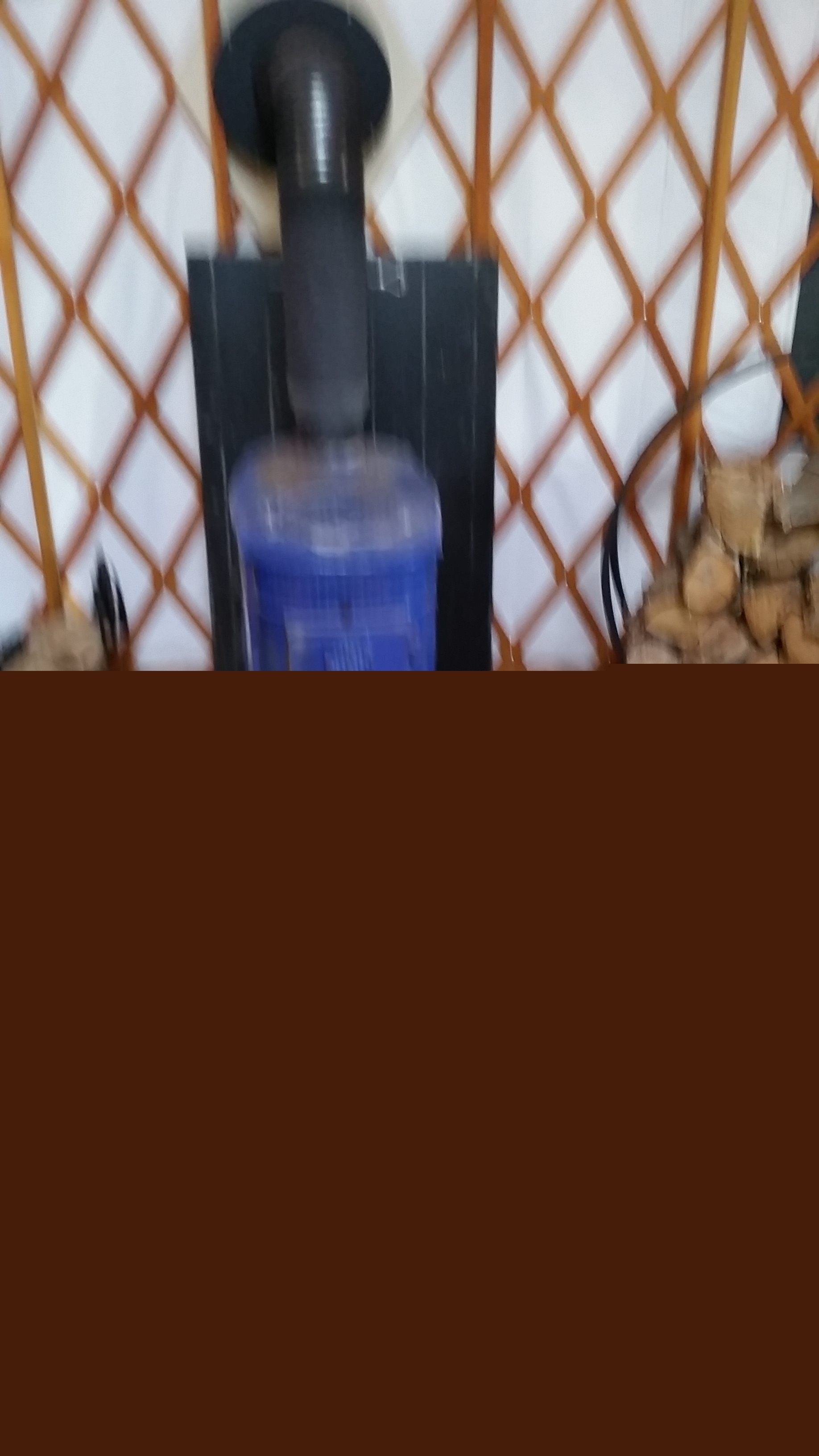

Today I trimmed off the excess cement board and then grout the tiles. My shop vac bit the dust, but otherwise, everything went pretty smooth. I think almond was the right choice on the grout.

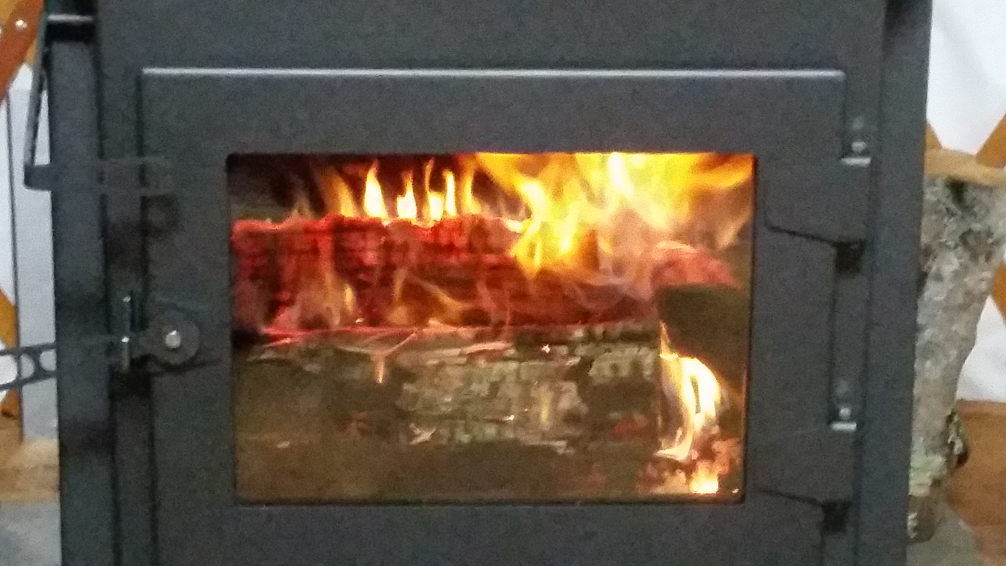

Default Re: New Woodstove For The Yurt
Okay, I just got back from our weekend. The install went well. We had temps of 20 degrees F and 30 degrees F each night. The first night I set the damper rather high (50%) and I had to reload it about 7 hours later. The next night I set it near 25% and 10 hours later it was still pretty comfortable in the yurt when I woke up (68 degrees) but the fire was down to coals.
That is a lot of variation on just a small change. I am thinking that after I use this stove a while, I should be able to get it to 12 hours @ 20f outside. I just have to get better at using a catalytic stove. I am learning a lot.
