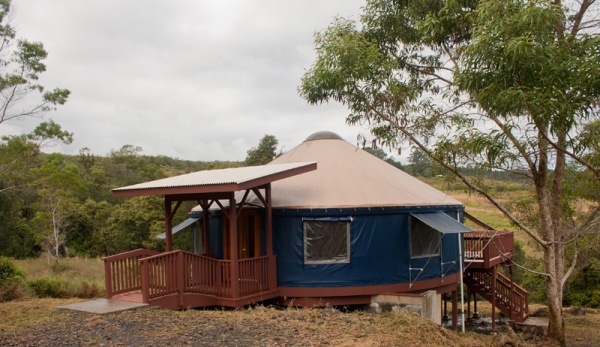

Hmm, this I have never done, but I am thinking Melissa has and will ping her to this thread. Tell me, will this be in an area where it gets cold? Will the breezeway between the two yurts have to be completely enclosed? I ask because I see in some of Melissa's work, they do thinks like this:
You could have that type of structure between the two yurts too if you live in a climate where having it open like that is no big deal. I like this option because it requires no modifications to fabrics myself. In fact, I am betting you could even enclose such a thing using standard building materials and
