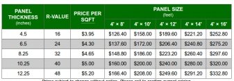

djspn 01-10-2013 02:06 AM
2 Attachment(s)
Here's something to give an idea re price, especially relative pricing of different thicknesses.
In addition to panal thickness, spanning ability also depends on the type of splines.
