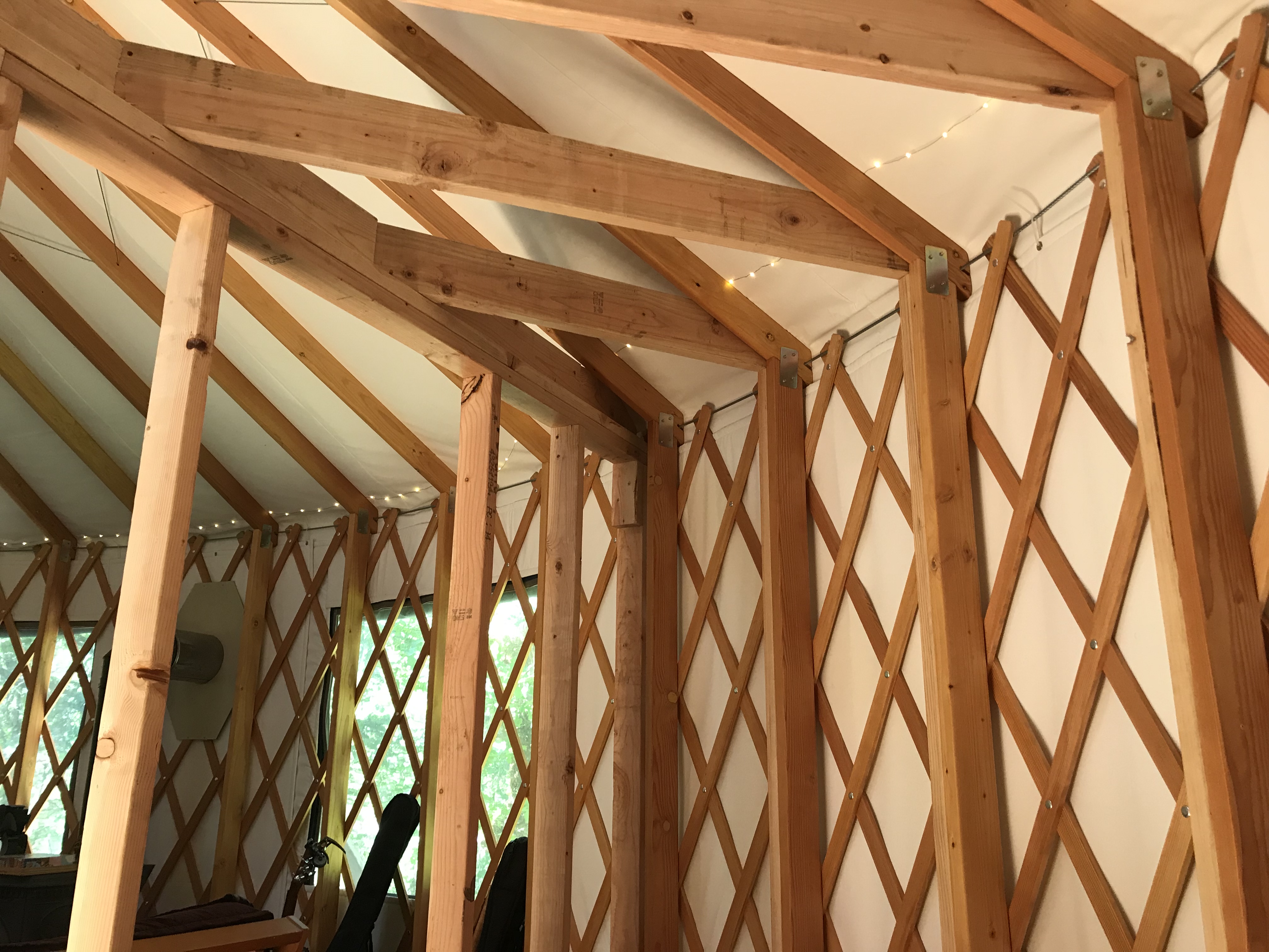

Thanks @albalmuth. I ended up running the loft/ceiling joists in line with the roof rafters. I sistered new studs to the existing ones so that I could rest the joists directly on those (maybe overkill, but
Pacific Yurts
strongly recommends not relying on the exterior wall or roof for strength). I'm pretty happy with how it all came together. The non-parallel joists make the new room ceiling and loft floor surfaces a bit of a pain, but I'm going to leave the bottoms of the joists exposed on the ceiling and I like that they will give the circular vibe of the yurt inside the little room.
Now we can talk above a whisper after 7pm!
