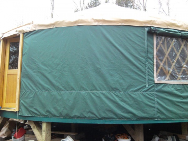

How we did it on my yurt was to bend plywood all the way around it and have the plywood come 1" over the deck. You kind of get the idea here:
You attach the walls to that skirt with screw/grommets:
Does this make sense?

Hi Jafo,

No wire along the bottom, just the top. The studs are there for snow support more than anything else.
BTW, the lattice is anchored to that skirt (or floor, can't remember) with a little bracket.

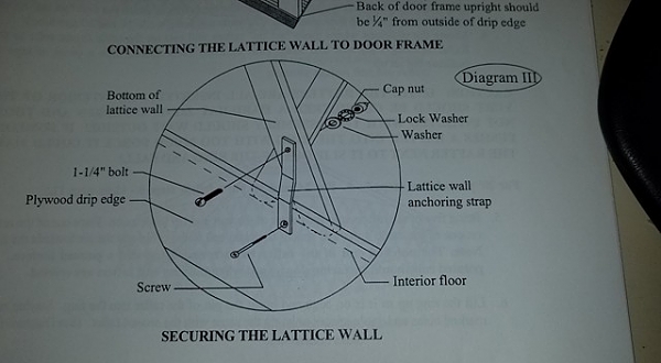

I dug out my
Pacific Yurts
install manual and they have a perfect illustration of it:

That's a nice clean anchorage, better then my ell brackets screwed to the interior.

Hello njtool,
If you look at this pic you can see how I build in the platform straps to the lattice when assembling it. We make them out of 18 gauge galvanized steel.
As you see in this pic it screws into the platform of the yurt.
Watch out however because there is still a relatively sharp metal bracket here that would touch the fabric. That is why after this pic was taken another bent piece (exactly as Jafo described) goes around on the outside of the brackets.
-Cheers
